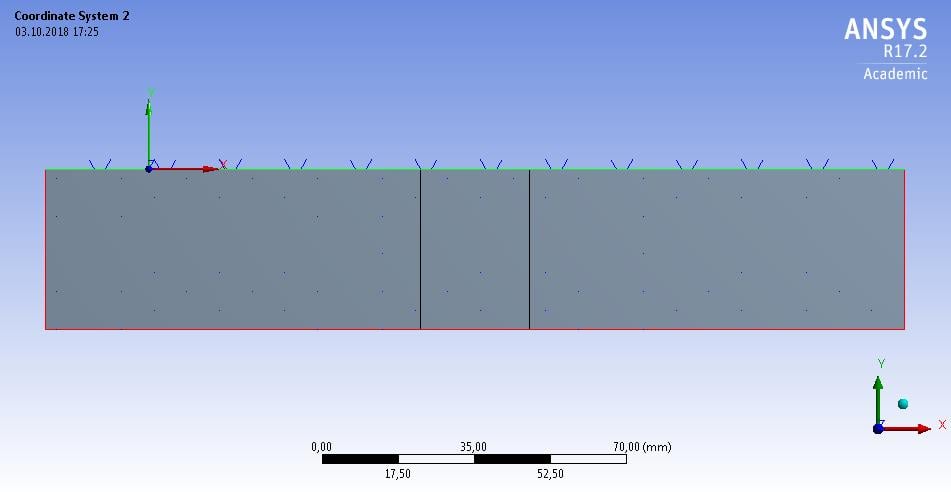

      i have a question reagarding the linear periodic symmetry. I want to model an infinite array of blocks like in the picture.
      I am not sure about the right settings for the symmetry. As low and high boundary i choosed the three faces on each side (you can see the blue faces in the picture). The direction of periodicity is the x - axis, but what is meant with linear shift? No matter what i choose - i will get an error message with a failed meshing.
      Thanks for your help!

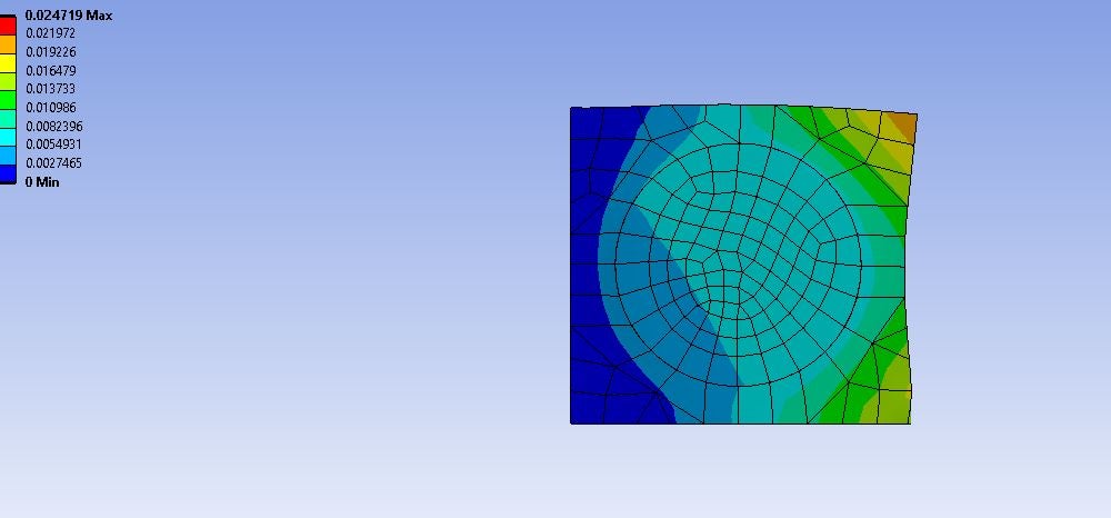

    • Johnson Ezenwankwo
      Hello Peter, I did a simulation to obtain the homogenized properties of a UD RVE. XTension case comes out like so, with the edges pulled farther out than the other parts of the XFront. I feel something is not right as Abaqus gave different results both in deformation and values.  Ansys
