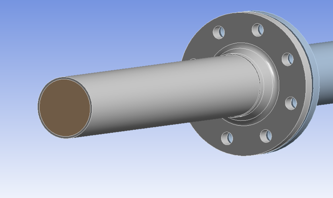

      Can you create named selection of the body(brown volume)
      Then create another named selection,
      Filter 1: Select body from named selection
      Filter 2: Select the nodes
      Filter 3: select nodes with your coordinates
