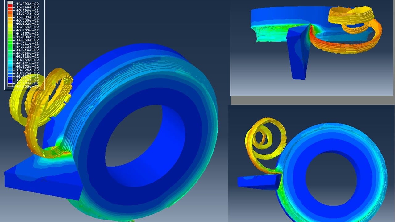

      I am trying to simulate a manufacturing process which is turning where the workpiece (steel) will be rotating and the tool(tungsten carbide) is stationary I wanted to model the temperature distribution in this process.
      I am using Johnson cook material model for flow stress3D simulation3D simulation
