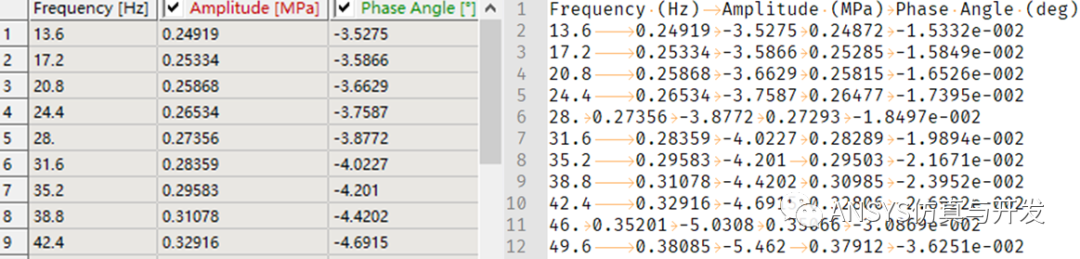

    • chenqingsen
      Yes, I want to export the result table data to txt file in ACT, but what i want is not doing right mouse button clicking on the results object in mechanical,it is that we do right mouse button to export table result.

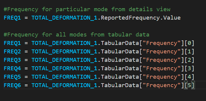

      In 2021 R2 there could be a possible way to do what you need, and with the native documented and supported act/api calls.
      See in the help manual for act scripts, it is called:
      act_script_demo_modal_acoustic
      Thank you and kind regards
      Erik

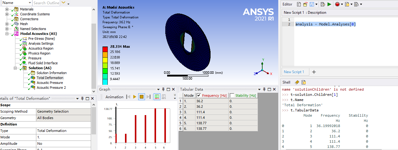

    • chenqingsen
      You mean this ? It seems that we can get the table data from python. OK. I will try after installing ANSYS 2021R2, thinks

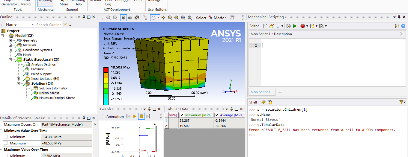

    • chenqingsen
      in the static structure, it can't work.
      But in Modal Acoustic Analysis ,it can work.
      So why ?
    • erik.kostson
      Hi
      Unfortunately I do not know, but it seems it is not working for static deformation results.
      All the best
      Erik
