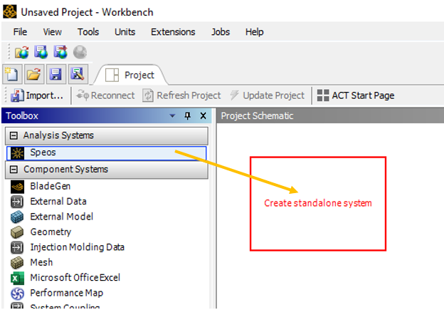

      Then launch Workbench. Darg and drop a Speos toolbox in the project schematic like this
      Right click on Geomety then Import Geometry and select your Speos project.

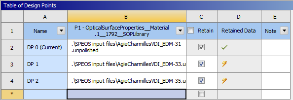

      Double click on parameter set
      On the right part, there is the ‘Table of Design points’. Here you can  right click on DP 0 and duplicate it as many time as you need (number of configutations) and on each new design point (DP) you can change the file name
      Save the project.

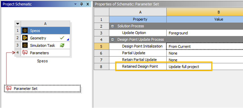

      Back to the project tab, you can Update all design points (will work only if you have an output paramete) or  when parameter set is selected, chande in the propertie Retaiend Design point to Update full project like this :
      Then you can update all design points.
      Workbench will create one folder for each confuguration with the project corresponding to this configuration and launch the simulation.

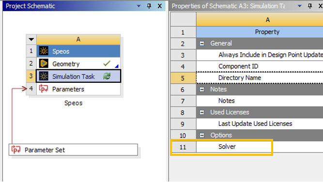

      When selecting simulation task, in the propertie you can also choose the GPU solver

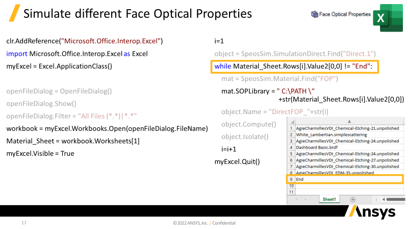

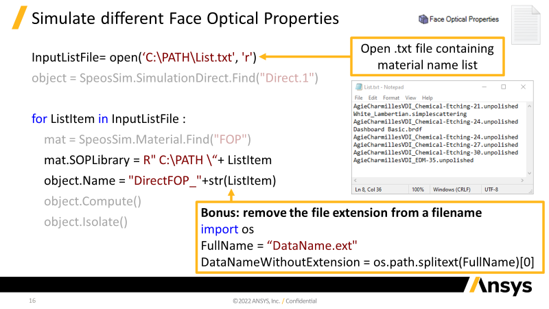

      You can start scripting with something simple like this:
      And then elaboorate with an Excel File:
      Speos API: ANSYS SPEOS Automation 2023 R1
