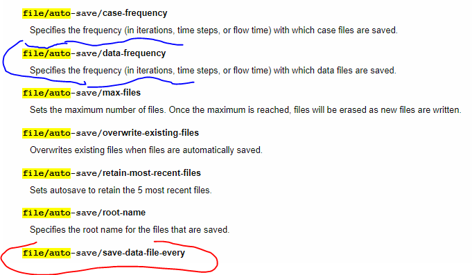

      Thanks, Kremella. I did find the TUI commands in the Fluent command list to save data. However, I did not find how to save DPM variables in transient tracking and transient simulation. As I mentioned, I need to save particle velocity after every 5-time steps. What TUI command should I use for it?n
    • Hafiz
      I am using the blue marked TUI to save solution data files. Is the red one for DPM variables?n
