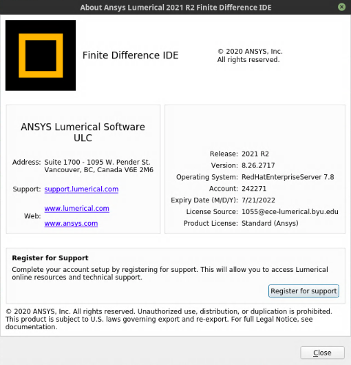

Ansys Employee,so you create the simulation file from your local computer using the script and not from the Lumerical installation in the cluster? If this is the case, can you send the About page of FDTD that you used to create the simulation file with your script?
October 4, 2021 at 4:51 pmihammond
SubscriberYes, sort of. The installation for the cluster is the same computer as the local machine. I remote into the supercomputer (without using a cluster, just accessing the front end) and create the script using fdtd-solutions on the supercomputer. Then I run the file on the cluster (which is governed by the same computer and same lumerical installation), but this time i use fdtd-engine to run it because it is a cluster. This is the about page, and attached I've included the python script (and supporting text files called by it) that create the fsp file. The python script is labeled python_script.
October 5, 2021 at 12:08 amLito
Ansys EmployeeBased on your submit script to the cluster, you are running using only 1 node with 5 processes. Does the issue happen with monitors enabled using more than 5 processes on 1 node? Or it only happens when you are using more than 1 node?
October 5, 2021 at 12:10 amihammond
SubscriberThe issue happens as long as thereÔÇÖs more than 1 process, not necessarily dependent on the number of nodes.
