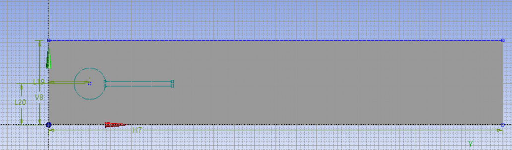

January 16, 2021 at 6:01 pm
kashfia.mahin
SubscriberJanuary 18, 2021 at 11:28 amRahul Kumbhar
Ansys EmployeeYou can use Project sketch to project it on surface and then copy that project area. Or you can use 'Extrude' with slice option to slice the surface using sketch.nViewing 1 reply thread- The topic ‘How to split two parts from one surface?’ is closed to new replies.
