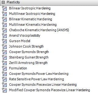

      I am combing elastic and viscoplastic material models to analyze stresses in a solidifying body.
      I am able to incorporate Young's modulus and Poisson's ratio as given in the image but not the yield stress.
      I need to incorporate yield stress value varies with temperature.

      To input stiffness as a function of temperature add the 'Structural Steel NL' from the general non linear materials library. Under the Bilinear Isotropic Hardening heading you will have Yield Strength and Tangent Modulus which can both be specified with respect to temperature. There are other non-linear elastic models you may want to explore also.

      There are many forms of plasticity available that can be added to any mateial. Simply click and drag from the toolbox on the left onto any material in Engineering Data.
      Because your project is material dependant it will be important to consider and select the correct material model.
