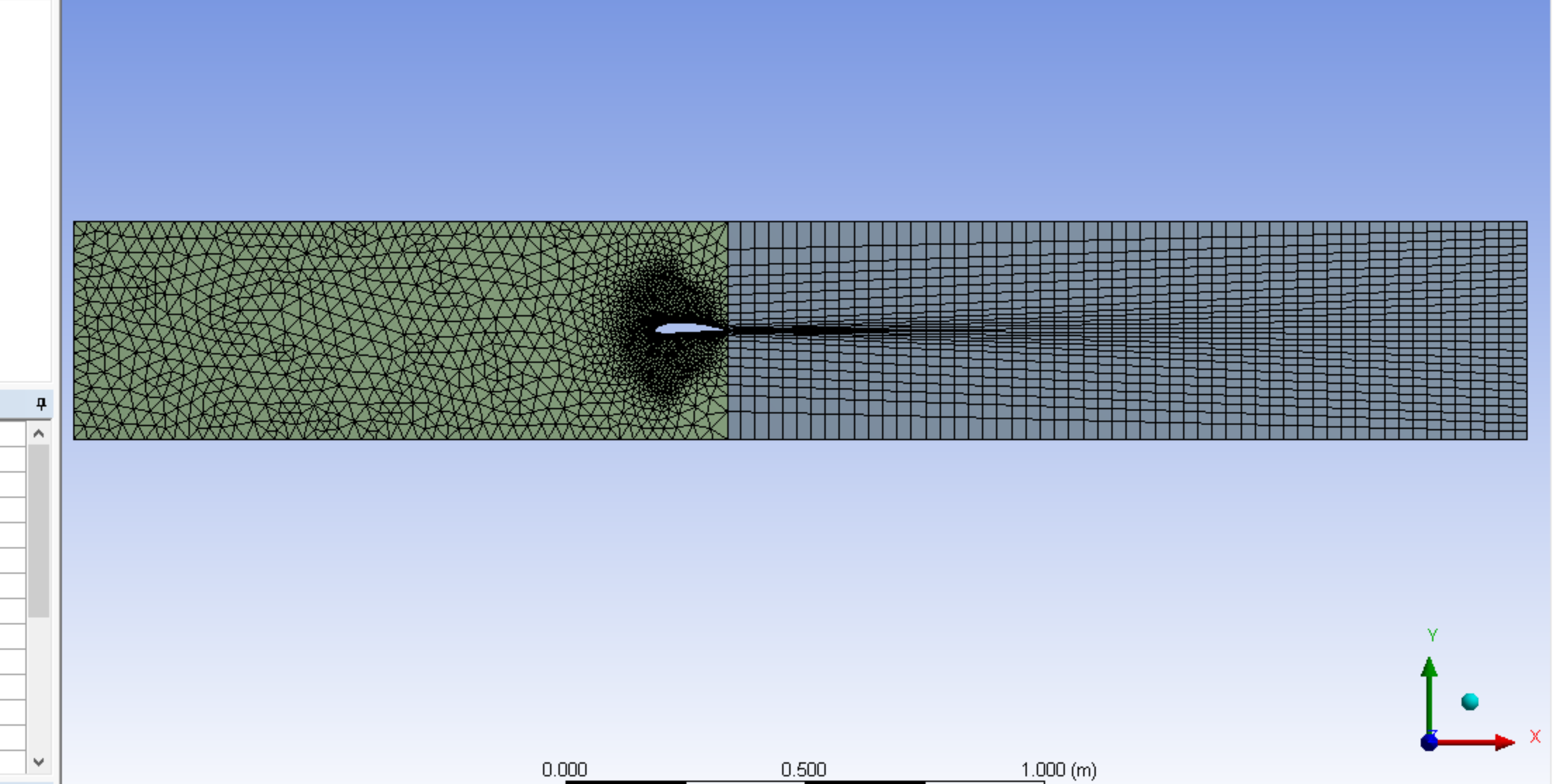

SubscriberI am simulating a foil in Ansys Fluent. When I used inflation for meshing, orthogonal quality hits under 0.1 in trailing edge, which is not desirable. Therefore, I used slice in trailing edge in order to fix this flaw.
However, the fluid domain is divided into two distinct fluid domains. I do not know how to define boundary conditions (inlet, outlet, walls, ...) after slicing which leads to two separate domains. Can you help me how to specify boundary conditions in this case?

SubscriberSet the slice faces as Interior.nUse Shared Topology and delete any automatically generated contacts to minimize the interfaces that are created after slicing.nSeptember 28, 2020 at 1:28 pmshayanmehr
SubscriberDear friend thank you for your response.nBut what are inlet, outlet and walls for this case?nI am confused how to set them because there are two separate domains (with the same fluid characteristics). Two domains can be seen in below picture, the left one which is in green color and the right one.n

SubscriberThe inlet is the left face of the left domain, the outlet is the right face of the right solid.nI expect you should choose Walls for the top and bottom faces of the two domains.nUse Symmetry on the front and back faces of the two domains.nUse Interior for the faces that touch in the center.nSeptember 29, 2020 at 11:09 amSeptember 29, 2020 at 12:39 pmRob
Forum ModeratorIf you don't you'll get a mesh interface just as the flow gets interesting. If the cell size is near enough the same you should be OK, but it's not something I'd recommend. Please post some images of the mesh so we can see what's going on. nMultiple fluid domains are fine; I usually have a few, and they're regularly used for things like source terms and moving reference frames. nSeptember 29, 2020 at 2:52 pmshayanmehr
