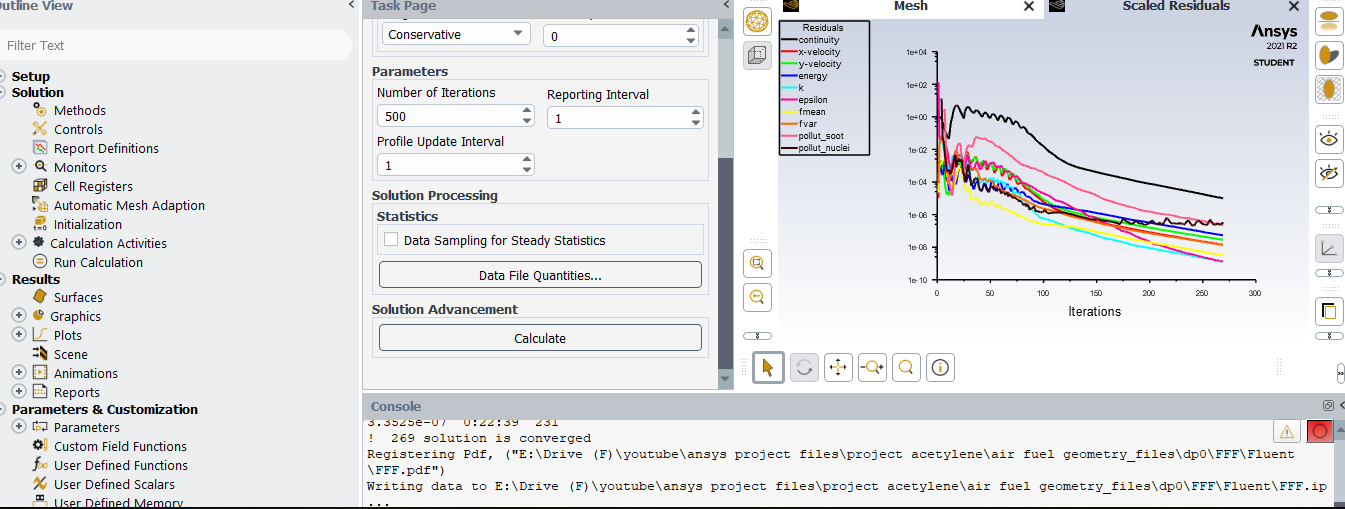

April 25, 2022 at 8:51 pmhbilal1076
SubscriberThank you very much for your reply.
Previously, I ran my simulation (only flow equation and no UDF addition) till 100 Iteration and it perfectly calculated I just came to know that when I run it with only flow equation (without UDF
) and set iteration till 500 then solution get converged at 269 (written in console).
For your convenience I am attaching you a screenshot.
TIA
April 26, 2022 at 2:34 pmRob
Forum ModeratorAdding brackets into the path is a really bad idea, but doesn't appear to be causing any problems at present.
If the model works without the UDF but fails with, then it's likely something the UDF is doing. Can you send the result of the UDF (ie what it's supposed to do to the flow) to a UDM and not have it alter anything? Then look to see if the result is sensible.
April 27, 2022 at 9:01 pmhbilal1076
SubscriberYes, it work well when I calculating it for only flow equation (without UDF) but when I add UDF and calculate, it give an error
Divergence detected in AMG solver: uds-0
Error at host: floating point exception
April 28, 2022 at 1:53 pmRob
Forum ModeratorYes, the scalar calculation is going wrong. What are you doing with the scalar?
