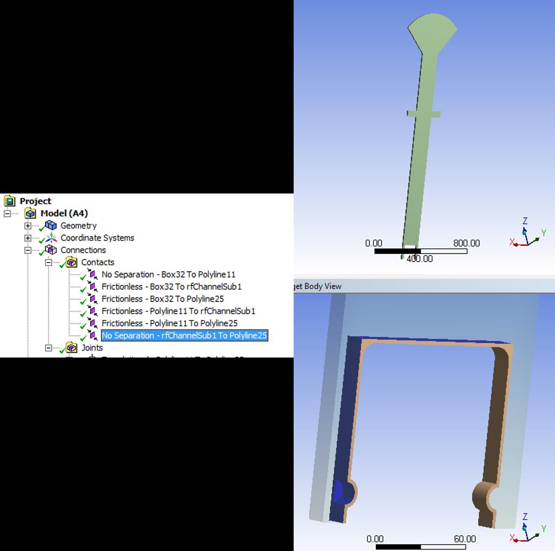

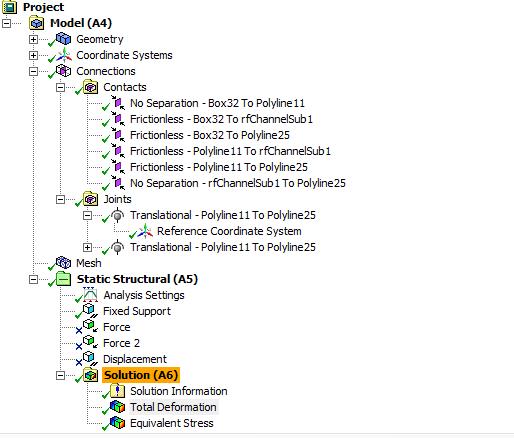

    • Han-yu
       Sorry, but I didn't understand how to add [metal spring-form and the "plug"] to my simulation.
      And I also took off the big flat board and using static structural.
      And I tried to use translational joint in my simulation, but the the result still not correct.
      The below picture shows how I do my simulation.
      Where should I add spring-form?? and how to do it correctly??
      Thank you.
    • Sandeep Medikonda
      Hello, I think Peter is just referring to the parts (the green one in your case). What are your parts named?
      When you say that the results are incorrect, what do you mean and how?
      ~Sandeep

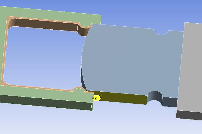

      The "spring form" I mean is the green one with the brown liner. How is the brown liner fastened to the green part?  If it is fastened, you should have a bonded contact between the green and brown parts.
      The "plug" is the grey part.
      I see the grey plug has a sharp corner where it is touching the brown spring. That will create very high stress on that corner. I recommend adding a blend radius to that corner so you have face to face contact, not edge to face contact when the displacement starts pushing the parts together.
      To do this insertion of the spring form over the fixed plug, you don't need so much geometry.
      Suppress the light grey long part and move the Fixed Support to the back face of the plug where the light grey part used to be.
      Make a cut through the green part, about a plug length back from the base of the brown part. Put a translation joint on that cut face so that it is free to move along the right direction.
      Use a joint load to add a displacement to move the spring form over the plug.

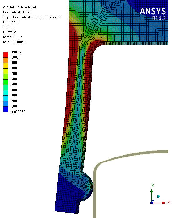

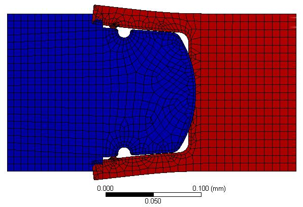

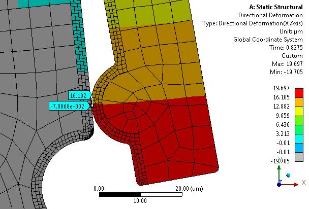

      Hi Han-yu,
      I agree with Sandeep, that two elements though the thickness is too few. Below is the model after being sliced into a quarter model.
      I saw the original model failed at a time of about 0.8, so in this quarter model.
      I tweaked the Translate in DM to 25.9 microns because there was a significant gap and I wanted to turn off Adjust to Touch. Now the contact is closed at the start of the simulation.

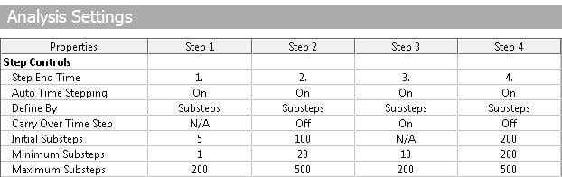

      I break the displacement into four steps. Step 1 has 0 displacement and is just to let the initial contact develop using 5 substeps. Step 2 used -0.0095 mm and I use minimum substeps of 200 to let the displacement get through the transition from the tip to the bump. Step 3 is the easy step along the length.  Then Step 4 has the final displacement to get through the difficult section to ease the clasp into the well.
      I will see how well this strategy went in the morning.
      Peter

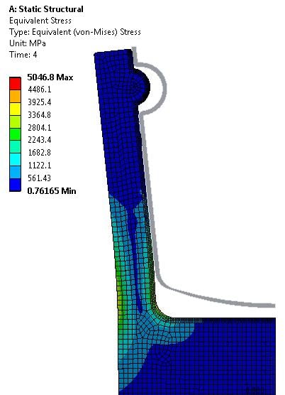

      Hi Han-yu,
      Step 2 had too short of a displacement, so it failed and I made it larger. I also wanted to cut the simulation time in half again. Look at the deformation in the clip. It is 16 micros in the X direction while the plug has only moved -0.07 microns in the X-direction.  This is good evidence that changing the plug to a rigid body will not incur a significant error in the clip stress.
      That let me get to a complete solution after I replaced the Fixed Support with a Fixed Joint on Polyline13.

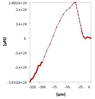

      Here is the Force vs. Displacement chart for the 1/4 model, start to finish is right to left on this chart.  This chart has to be multiplied by 4 for the full model.
      Both the Stress and the Force are the result of a linear elastic material model. Since the stress has gone way, way past the yield and ultimate strength of the nickel and silicon materials, the Force result does not represent reality.  In order for this simulation to represent reality, plasticity should be added to the nickel material. I guess silicon does not behave with plastic deformation beyond yield, I guess it shows a brittle fracture at its ultimate tensile strength. I don't know what that value is, but it is time to start paying attention to it.
      Here are the Analysis settings for this run.
      Here is the joint displacement.
      Here is the Frictional Contact details.

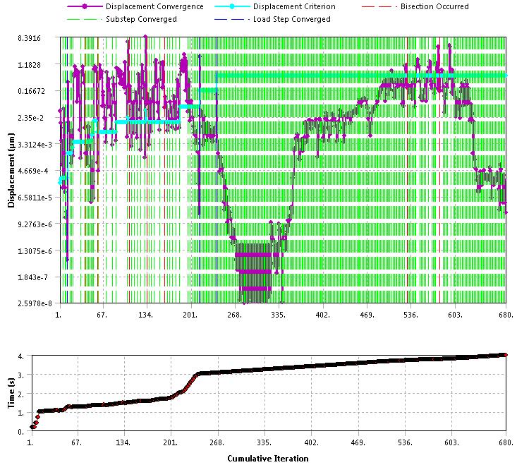

      Here is the convergence plot. The steep part in the middle of the Time plot is the long stroke with the bump on the side which can take large substeps between the difficult start and end part of the stroke that required small substeps.
      Let me know if you can get your model to run with these settings and mention the version of ANSYS you are using.
      Peter

      Hi Han-yu,
      Change Sweep Method 2 > Sweep Num Divs from 2 to 4 and it will start converging.
      Best regards,
      Peter

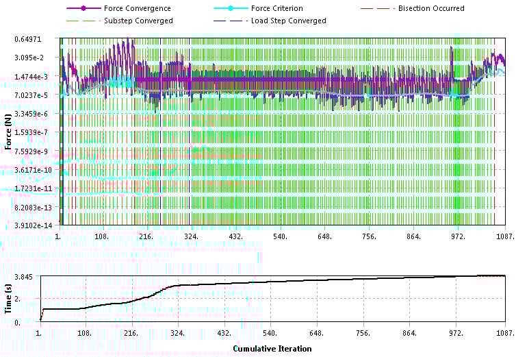

      When the solution fails to converge, you look at the Newton-Raphson Force Residual Plot and it shows you the problem is on the elements created by the Sweep Method 2.  They also have the worst aspect ratio and the fewest number of nodes along the sweep. Those are all the clues that said to try 4 instead of 2 elements.

      The unmodified model with 2 elements wouldn't start converging on step 1. The only change I made was to make it 4 elements then it did start converging through step 1. That modified model did not make it all the way. It failed to converge here:
      But in this case, the reason it stopped is because the displacement was larger than needed and the part ran into the other wall.
      I have attached the ANSYS 19.1 archive that I solved.

      Hi Han-yu,
      The only change I made was to take a zero out of the element size in this Face Sizing mesh control.
      Now it is converging in ANSYS 16.2
      Peter
      You still are pushing the joint too far.  Below is the Joint Probe of the Force to translate the Joint.
      You can see that step 3 could have been a little longer before the small substeps of step 4 begin.

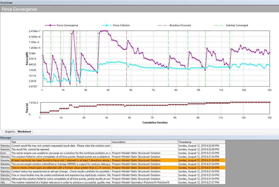

    • Han-yu
      Hi Peter:
      Sorry to bother you again.
      I faced a nonlinear converge problem, and the mesh size is limited by the current license.
      The error messages are show below.
      Could you help me take a look of my simulation?
      Thank you.
      Hello Han-yu,    [Edited]
      I'm glad to see you using Symmetry, but you didn't add in a Displacement BC to support the symmetry plane. Please add X=0 to the four faces.

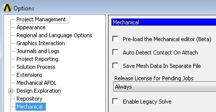

      You forgot to suppress the automatically generated Contact 7 that is bonding your sliding interface.
      In Workbench menu use Tools > Options and uncheck the Auto Detect Contact On Attach and you will never have to worry about that again!
      I took a 0 out of your Face Sizing to reduce the mesh density since a lower density ran well in an earlier model.
      I added a Command Snippet to the Static Structural branch that has the code:
      NEQIT,60
      which forces the solver to keep trying for longer than the default 26 iterations.
      In Step 1, I turned off Auto Time Stepping and set the Substeps to 1.
      I also made Step 2 have 500 Initial and 500 Minimum Substeps.
      In DM, I added a plane at the center of the thickness and created another plane of symmetry. This cuts the aspect ratio of the elements in half and provides the second plane that removes the need for a translation joint.
      I removed the translation joint and replaced it with a displacement on that same face.
      I made sure I was solving in the units of microns.
      You can make those changes now and see if your model converges.
      Peter
    • Han-yu
      Hi Peter:
      I suppressed the bond contact, so the simulation can go longer.
      But it still stuck as below picture shows.
      Could you teach me where should I modify?
      Btw, how could I add Command Snippet to this simulation?
      And the X=0 to four faces?
      Thank you.
      Hello Han-yu,
      All the changes are incorporated in this archive that seems to make good progress. The X=0 Displacement is only on two faces of the flexible body. It doesn't apply to the Rigid body.
      The only change I would make is to the Minimum Substeps in Step 2. 500 is larger than necessary. Back off to 100.
      The ANSYS 16.2 archive is attached.
      Peter
      Model stopped shortly into Step 3. Here is the Force-Displacement curve for pushing one-quarter of a clip into the plug. Multiple this value by 4 to get the full model reaction force.
      The force that is shown above is not real, it is an artifact of using linear elastic materials in a model that takes them past their point of failure. Therefore if the clip would have broken.
      The maximum tensile strength of Pure Nickel that I found was 1000 MPa, which has been colored red below, and the yield strength was 935 MPa. Annealed Nickel had much lower values.  It is difficult to find the ultimate tensile strength for silicon, but one reference was 120 MPa.
      If your goal is that this clip does not break off, then you are bending it too much and you should consider a design change.
      Peter
