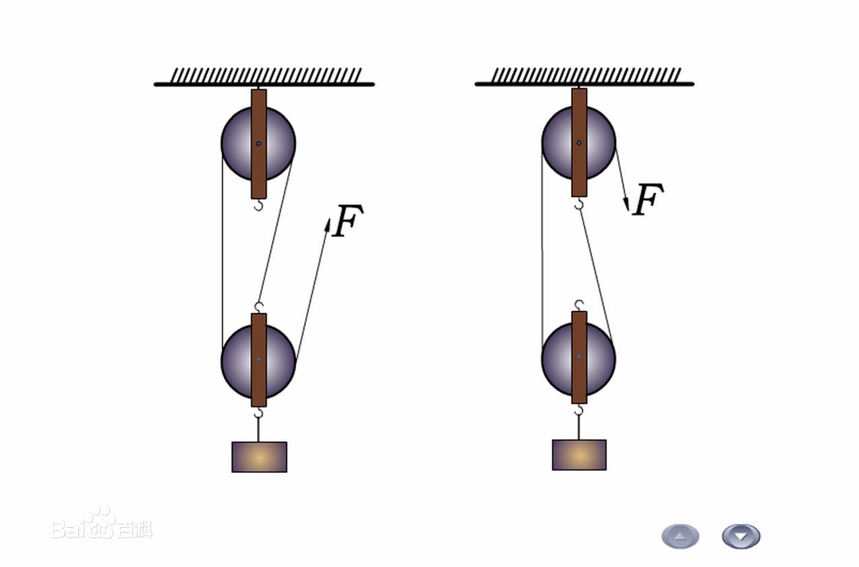

December 22, 2018 at 11:03 am
hustfocus
SubscriberAnalyze the motion and deformation of a fixed pulley block. The structure consists of a fixed pulley and a rope around it, with a weight at one end and a loading force at the other end to analyze the motion and deformation of the rope and weight.The sliding constraints between the rope and the pulley don't know how to define the effect of the rope on the pulley.Thanks. -

December 25, 2018 at 8:41 am
December 25, 2018 at 1:54 pm
peteroznewman
SubscriberYou are showing two pulley systems, the tension in the rope is shown to be equal to F, so one system is supporting a heavier weight than the other.
A pulley is made up of a sheave, the round part that the rope touches, two flat parts, the shaft between them, and the hooks on either end. Let's use the name frame for the assembly of parts excluding the sheave.
For both systems, there is approximately a force of 2F downward (or upward) on the sheave. Each system has an additional force on the frame where the rope terminates.
The stress on the sheave doesn't change much whether is is static or moving, other than the sheave would be at different angles as it the system moves, but if the sheave is rotationally symmetric (has no spokes, is a solid shape) that makes no difference.
"how to define the relationship between the pulley and ropes"
I suggested starting with a simple model, which applies a force of 2F to the sheave, why don't you start there? That simple model will "simulate the deformation and axial force and the stress" on the sheave.
If you want to add in the rope, then use frictional contact between the rope and sheave, but it will make the model a lot more difficult to solve.
Peer -
