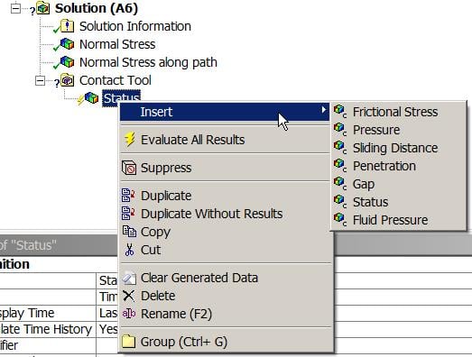

      We can use the contact status option to determine the status of the contact? But I want to know if the status can be seen according to particular direction, as per this example contact sliding in axial and tangential direction?
      Thank you.
      Best Regards,
      Rashiga
      Dear Rashiga
      Here are the results available in the Contact Tool.
      However, you can plot the directional displacement of each face of the two parts to look at the differential displacement.
      Regards, Peter
