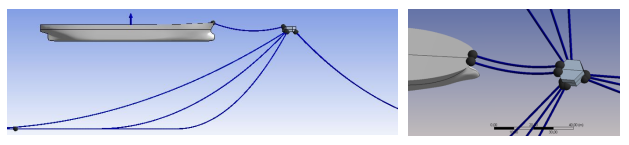

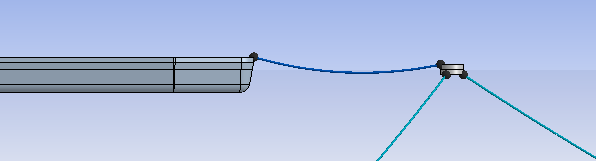

      Thank you very much, Mike. I was able to scale through that but i ran into multiple problems. Why is the buoy sinking instead of floating in the hydrodynamic response animation window.
      Before the hydrodynamic response solution
      After the solution.
      Also i noticed that my ship actually moved, maybe because i add current velocity (1m/s) in the solution.
      I also got multiple error warnings:
      1) Hydrodynamically interacting structures have move significantly from the analysis position result are inaccurate - movement exceeds 50%.
      2) CABLE DYNAMICS- WARNING - SLACK CABLE #3: The minimum allowable tension for the line is 64200.0. The minimum calculated tension for this line is 52928.6 move attachments further apart or shorten line. The cable 3 here is the hawser (line connecting the ship to the buoy)
      3) I also noticed that my hawser cable parabolic downward
      4) Mass/displaced mass significantly different for structure #2. difference = -19.5%. My structure 2 is the Ship.
      Mass/displaced mass significantly different for structure #2. difference = -51.9%. My structure 1 is the buoy.

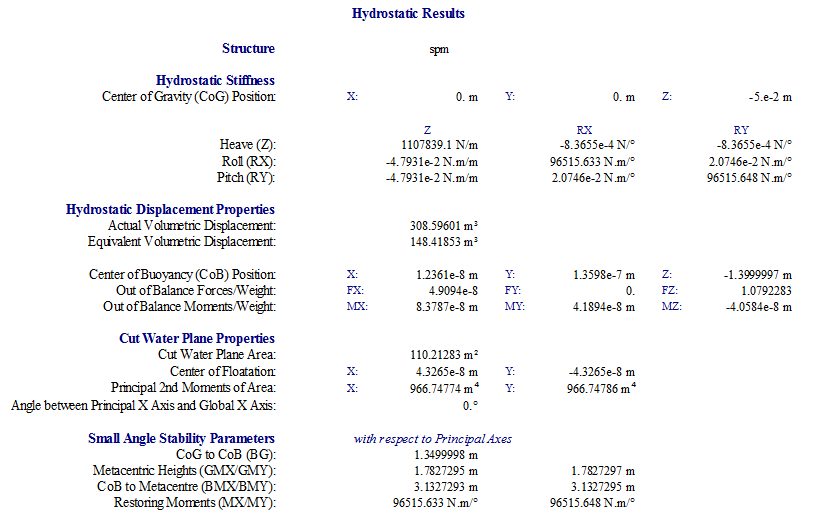

      This is the hydrostatic results obtained from the buoy:
      Thanks for any idea that will help me solve this problems.

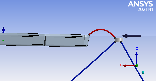

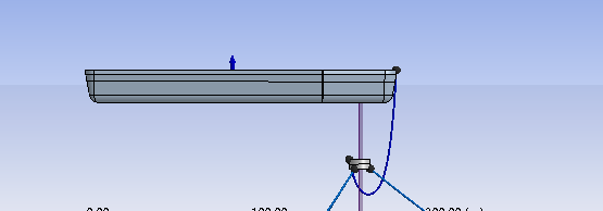

      Goodnews! I was able to find my way around some of those challenges I posted earlier but I did run into another serious problem, "hydrodynamically interacting structures have moved too far from the analysis position movement exceeds 75%".
      From the animation, the FPSO actually moved, colliding with the buoy. I guess that's part of the problem.
      Please I need your help. I have been stock here for days without any solution.
      Thanks.

      For the error of 'hydrodynamically interacting structures have moved too far', it helps to understand the hydrodynamic interaction calculation in the Hydrodynamic Diffraction analysis. When we perform the analysis for a group of interacting structures, the frequency-dependent added mass and radiation damping matrices are calculated to include the hydrodynamic interaction effects between each structure. However, these matrices are only strictly valid for the structures in their relative analysis positions. In other words: if the distance between the structures increases in the time domain, we would expect the radiation effect to reduce, but the matrices are not recalculated, so the radiation effect stays the same. Therefore the time domain Aqwa solver issues warnings/errors as the relative positions of the structures change in time. If the relative positions change too much, the Aqwa solver stops to prevent very inaccurate results.
      Looking at the error message in your screenshot, the part 'stopped at time = 0.00' indicates that the relative positions have already changed too much when the time domain calculation starts, i.e. the movement is occurring during the upstream Hydrodynamic Response stability analysis. To try and fix the problem, you could write down the structure positions at the end of the stability analysis (when the structures are in equilibrium), move the structures in the geometry editor to these positions, then re-run the Hydrodynamic Diffraction analysis. In this way you can ensure that the hydrodynamic interaction effects are more accurate in the time domain, and the Aqwa solver should allow the analysis to run.
