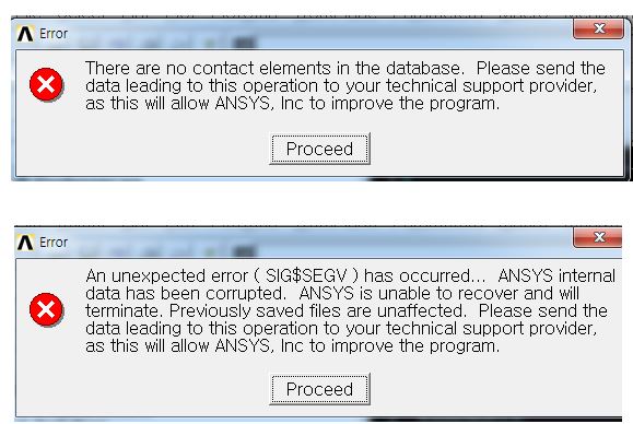

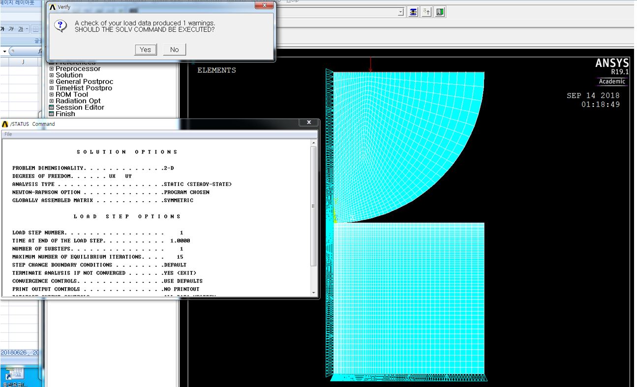

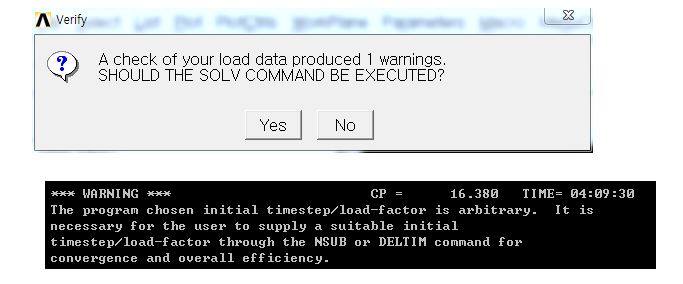

      Hello~
      I'm beginner of ANSYS APDL.
      I'm interested in contact stress.
      I have been trying for it with the text "ENGINEERING ANALYSIS with ANSYS SOFTWARE (Author: Y. Nakasone and S. Yoshimoto)".
      The Contact stress problem is described in 120page ~138page in the text.
      I have followed the text, But I can't get the solution.
      What is wrong ?
      I have added the capture image for the contact stress problem from the text.
      Plz, refer to the link below for details.
      https://drive.google.com/file/d/16KlDF9rfwiavOuHUf8gOBvPjTIbJ4Nb6/view?usp=sharing
      Plz, refer to the link below with Input file
      https://drive.google.com/file/d/1mdRnHIxMYPpS_o5oCdPq5f_w6h13CSvv/view?usp=sharing
      Thanks.

      Sandeep Medikonda
      Hi Nuno kon,
      You are missing contact...not sure how it got that way, but the message suggests database corruption.  If you cannot add in the contact to the existing model, you should just start over.
      cdwrite/cdread sometimes resolves db corruption issues.
      Sandeep
