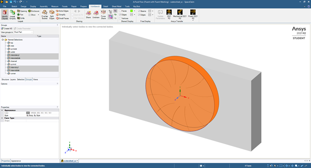

SubscriberI am trying to set up a simulation of waterwheel using Fluent with Fluent Meshing and handle the static and rotating regions using sliding mesh. However I observed the nodes at the static interface move along with the nodes of rotating interface, which results in distorted elements at the interface. Any suggestions to solve the problem?
For your information, the geometry was set up using SpaceClaim, and "Share Topology" was applied with the interfaces shown below:

Forum ModeratorFluent Meshing doesn't let you set up the non-conformal. If you use Fluent Meshing you need to then slit the interior boundary between the wheel & background. The easier approach is to mesh the two bodies separately and then append the wheel mesh in Fluent: be very careful with units as it's common to read one mesh in mm and the second in metres.....

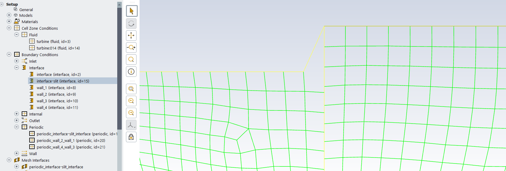

Now, we can close Fluent Meshing and run Fluent for solution set up. The mesh interface can be set up by change type of the interface zones from Internal to Wall, and then to Interface, and finally apply the "Manual Create" feature. In this way, when the nodes at rotating interface move, the nodes at the stationary interface do not move, and thus the problem with distorted elements has been solved!

Forum Moderatorpretty much, there's an easier way using slit boundary (/mesh/modify-zones in the TUI) but your way is "easier" for a less experienced user.

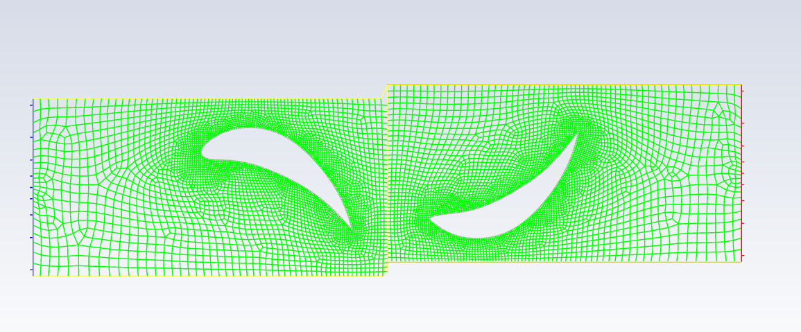

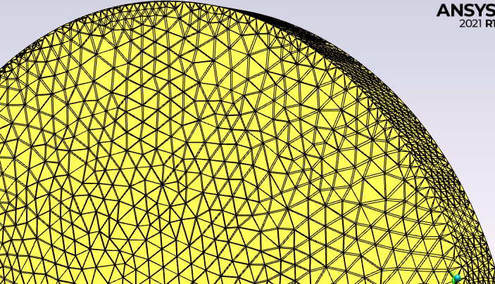

SubscriberHello Rob, sorry to intrude. I am facing similar trouble and I used 'mesh modify-zones slit-face-zone' to decouple faces to form slits and then to create interfaces. As with the case, the node seems of the sliding interfaces are not decoupled and thereby, leading to skewed cells (fig.1 - after I timestep of 1e-5s) and negative volumes. I also tried appending two domains individually and it worked for the interface but caused another issue. This issue is that when I am converting tet mesh (created in icem) into polyhedral (in fluent), I am getting regions with holes (could be some tolerance issue?) on the interface. Any pointers on how to make sliding mesh work (decoupling) without going through the individual importation of two domains. Interestingly, the holes in polyhedral conversion are not observed when they are imported as a single file.
