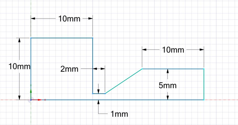

SubscriberHi, I'm trying to simulate magnetohydrodynamic flow in a multiphase VOF analysis using the Fluent MHB add-on. The model is an asymmetrical model. The simulation consists of a reservoir with liquid metal and when a magnetic field is applied to the reservoir (using an electromagnetic coil) pressure inside the reservoir would increase resulting in the liquid metal to flow out of the nozzle.
My question is how would I set up the MHB model. Also if there any simple examples so that I could familiarize myself with the add-on module.
