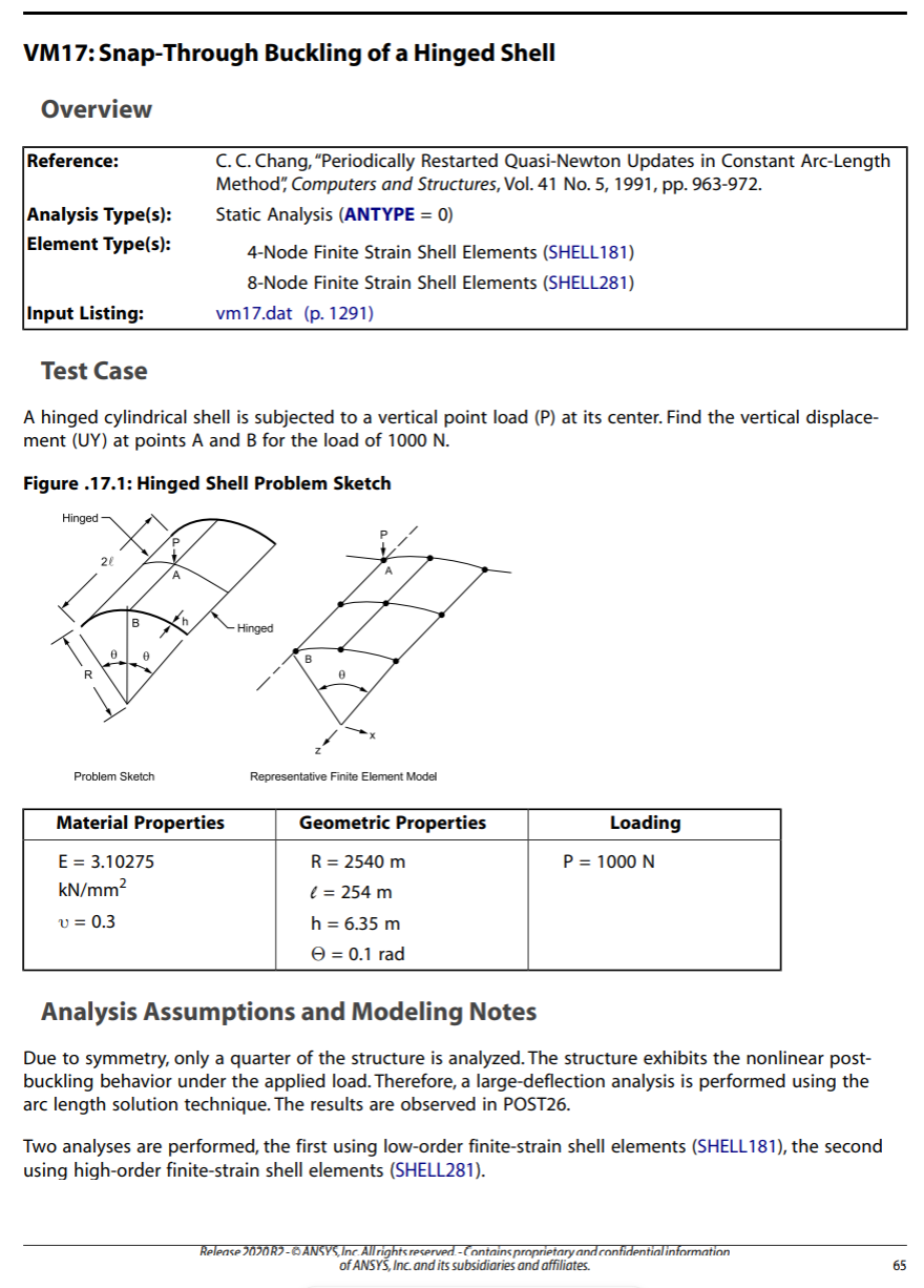

SubscriberHello I am working on VM17 and I have set everything up according to the image. Below
However I am having trouble setting up the hinged support. I was told by my teacher that I needed to use "Fixed Rotation" which I added and set the Rotation of Y,X to fixed and left Z free. However I am getting an error saying there arent enough constraints. Any advice on how to set it up correctly? I tried adding various supports to the edges, but i am just unsure on how to set it up.

See that vm17 example in our help and the commands used (D command) - hinged supoort is all rotations free, and displacements UX=UY=UZ=0.

Ansys EmployeeHi
I will try to explain even more in detail.
Let’s start from the beginning.
Shell elements so the ones you use now in workbench mechanical, are called shell181(4 nodes/element) or shell281 (8 nodes/element).
They have by default six degrees of freedom at each node: translations in the x, y, and z directions, and rotations about the x, y, and z-axes.
So a hinged support as seen in vm17 example, has on the hinged edge, the translations in the x, y, and z directions = 0 , and free rotations about the x, y, and z-axes.
To create that hinged boundary condition (BC), you pick that edge and insert a Displacement BC, and set X, Y, Z Component = 0. See here how to set up such a displacement BC. /courses/index.php/courses/high-resolution-fe-model-of-bone/lessons/physics-setup-lesson-5-14/topic/4-boundary-conditions/
So, that is how to set that hinged support up.
To close of this post, in your model you have a Fixed Rotation BC. You need to remove this Fixed Rotation. Now you might as why? Because as we said, on a hinged edge all rotations about the x, y, and z-axes are free.
