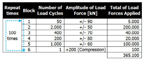

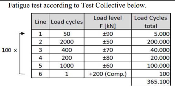

I am performing a Fatigue Analysis inside Static Structural. I need to input the Load Force as a Load Block Force, as showed below:

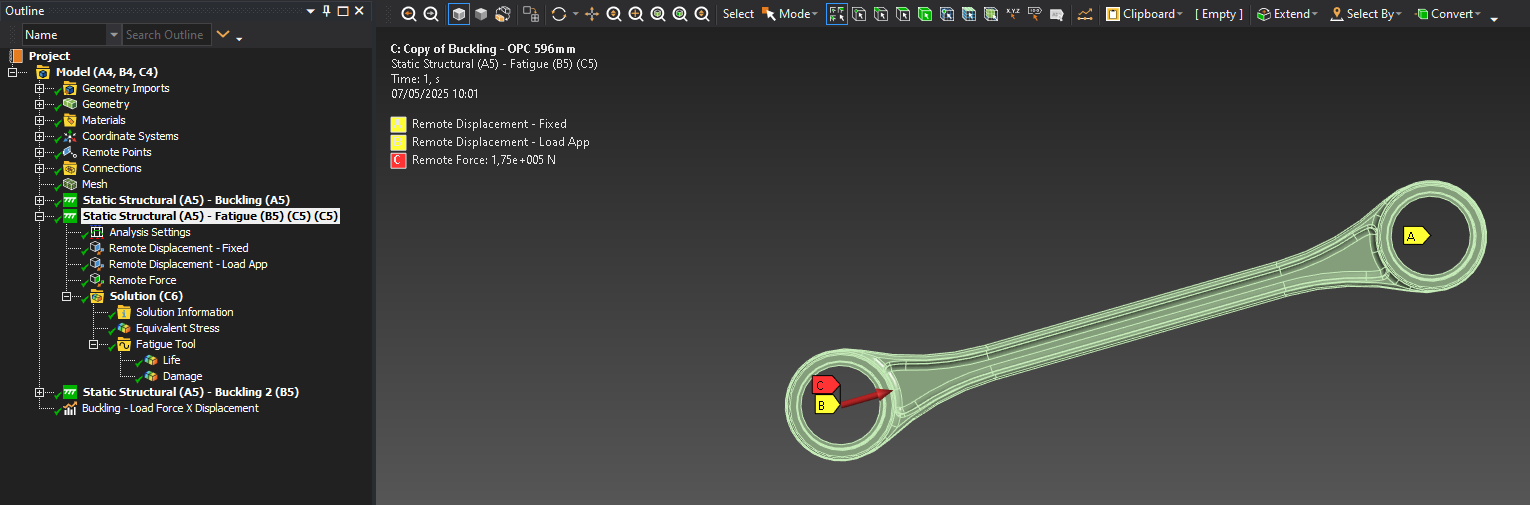

However, I do not know how to do it. Below is my Project Outline Structure:

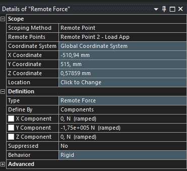

Where I can set up this specific load block force? "Remote Force" as "Tabular" or "Function"? "Fatigue Tool Loading" History Data? Do I need to elaborate a matrix, xls, dat or txt with the load forces?
Load forces are only in "Y" Direction, compression and tension.
Thank you!
