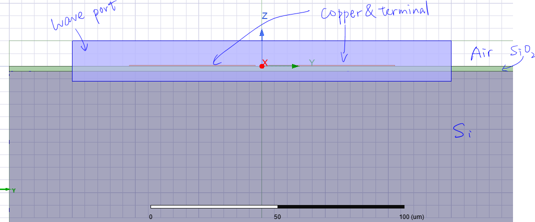

SubscriberHello! I encountered some problems when simulating and designing coplanar strip lines (or differential lines) using HFSS, please help:Â
1. I can run the official example differential_microstrip.aedt normally, but when I removed the metal boundary condition at the bottom of the air box and replaced it with a radiation boundary condition (removed GND), I ran again and encountered an error: Solving adaptive frequency ..., process hf3d error: Too few conductors were found on port 1.  There should be one conductor for each terminal, with one additional reference conductor.  Unintentional contact between conductors may cause this error.. Please contact Ansys technical support. Must this GND exist? Can I set one of the coplanar strip lines as the signal line and the other the GND, like a coplanar waveguide (CPW)? Additionally, Deembed seems to have a significant impact on the results. What does this variable mean?
2. My ultimate goal is to design a pair of ground-signal (GS) electrodes (sub millimeter level) on the chip with a frequency range of around 0-20GHz. The substrate of the chip is silicon (hundred um level) and silicon dioxide (um level), as shown in the schematic diagram below. Therefore, there are electrodes and two substrates within the range of microwave wavelengths. How should I set waveport and terminal to obtain the correct results? Should the size be set to about ten times the electrode width or spacing, as in CPW, or should it be set to near the wavelength level?

SubscriberHi
I did a similar simulation recently.Â
Assign a modal waveport with one conductor as signal and referencing to the other conductor as ground on both sides.
The port would be 5`10 times the height of the substrate in Z direction and in the Y direction, 5~10*(width + gap).
Once you run the simulation, you will be able to see the excitation mode under port field display. and it should look as below.Â
So the port size will vary with varying substrate height, CPW width and gap.

SubscriberHello, I have a similar challenge. Trying to design the coplanar stripline on GaAs substrate of thickness 500um. What port size should I use?Â
May 16, 2024 at 8:12 am
kirthika
SubscriberI tried the port size I recommended above. It did not correlate with a published work and another software.Â
I used 5 to 10 times the height of the substrate 100um and the port was too narrow for very thin line widths.
Could you recommend the port size for a substrate of 100um and 500um?
Coplanar lines of width 4um and 2um spacing.
