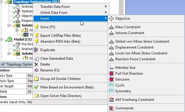

      You can set up different response constraints by right-clicking on the Topology Optimization Cell in the structure tree. For Static Structural you would have:

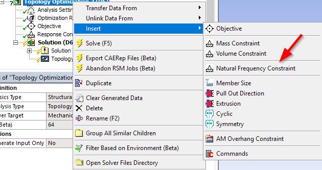

      for a dynamic or modal analysis you have a frequency constraint instead:

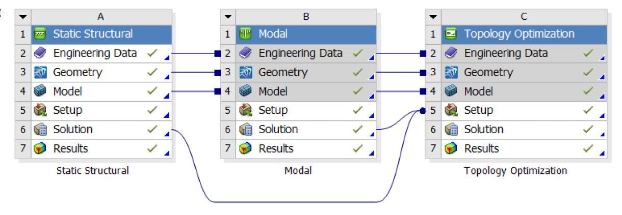

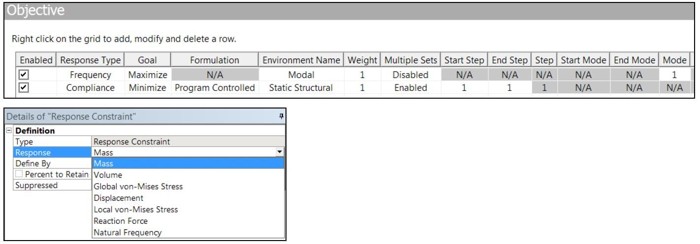

      Coming to your question. For the objective of static analysis, by minimizing the compliance you are directly maximizing the stiffness. However, for modal analysis, you only have the option to maximize the frequency along with minimizing mass or volume. Which if you think about it, indirectly is maximizing the stiffness. Now you could also couple a structural and modal analysis and feed it into a topology optimization cell, i.e., set up a coupled static/dynamic objective
      Note that you could play around with the weights to control the contribution of each objective
