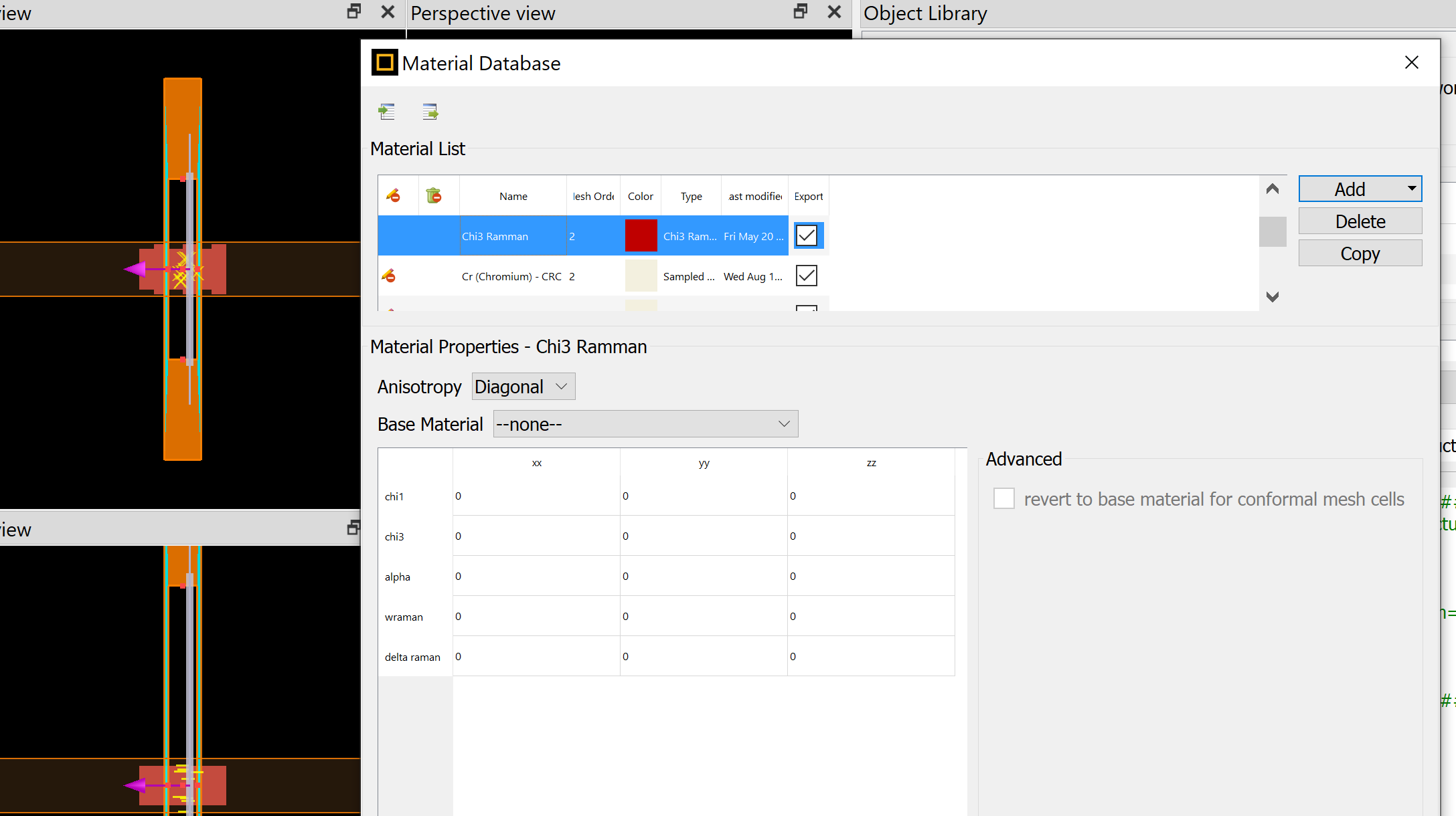

SubscriberHello,
How to set chi3 in the form of third-order tensor in the nonlinear simulation?
May 20, 2022 at 6:57 pmGuilin Sun
Ansys EmployeeCurrently the full tensor is not officially supported. But the diagonalized tensor should work :
Please try this if you have diagonal tensor Chi3.
If you want off-diagonal tensor, you will need to develop your own plugin dll, and it is little supported from our side: Flexible Material Plugin Framework

Ansys EmployeeYou are right that the general 3rd order tensor has 27 elements. Lumerical's plugin material model can model 3by3 so it is simplified to xx,yy,and zz, meaning only ExEx,EyEy and EzEz terms are included.
I do not know which tutorial you are referring. For anisotropy material, yes you can use Matrix Transformation attribute to set such materials. Basically it diagonizes the full matrix into diagonal matrix and transformation matrix. However, not all 3by3 matrix can be diagnozed, in particular for broadband. This attribute is only used for anisotropy materials, not for non-linear materials.
