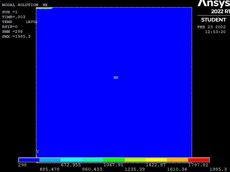

I have been trying to simulate electric discharge machining (transient thermal analysis) on a 2D axisymmetric body using ANSYS APDL software. After obtaining a temperature distribution, I now want to kill the elements above the melting temperature in order to obtain a crater. Can anyone guide me on how to proceed further to get the required results? I'm pretty new to ANSYS so any relevant answer or material would be appreciated

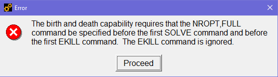

Subscriberthank you for your swift reply I followed a similar procedure to the one you stated in your answer and was able to select the elements above melting temperature using esln. But, when I try to kill the elements using EKILL,ALL., The following error is showing up. Where did I go wrong? This is the code that I used. I just want to mention that I am doing the whole analysis using ANSYS APDL only and I was giving the code input line by line.
/solu
*do,time_val,0,1,1e-3
!!! Apply load
solve
nsel,s,temp,,1400,1900
esln
ekill,all
Thank you

What we said is that we need a combination of nsel, esln, and ekill commands to do this.
As the message says though the nropt,full needs to be specified before solve and ekill.

SubscriberThe Birth and Death require Full Newton-Raphson solutions. You can active the option by adding the command: NROPT,FULL
NROPT, FULL
/solu
!!! Apply load
solve
esln
ekill,all

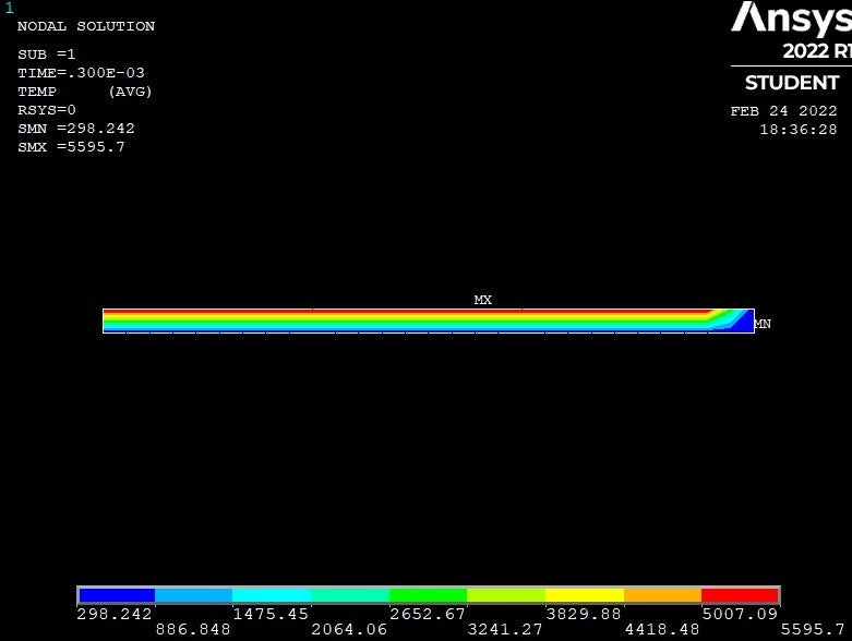

But, I am facing one problem here. Even though I am using the code
nsel,s,temp,,1400,10000 !to select the elements above 1400 K
esln
to select the elements above the melting point, the elements which are not present in the temperature range are also getting selected. Can you please explain how to tackle this problem?
As you can see even though I gave a range of 1400 K to 10000K, the elements below 1400K are also getting selected
