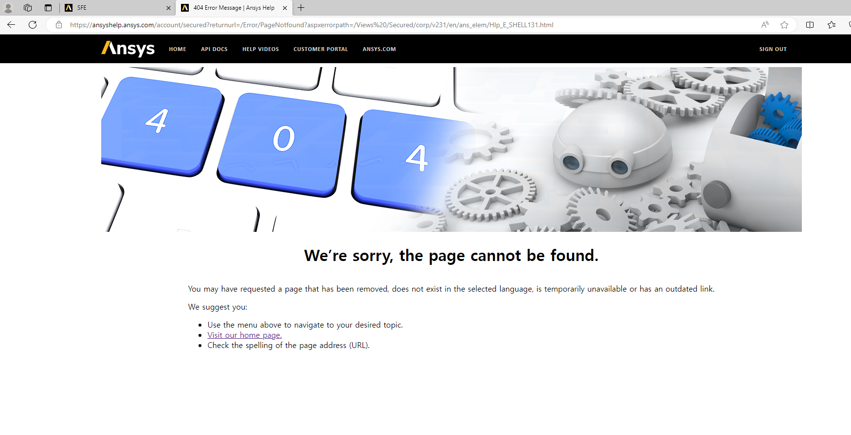

        • Ji-Hyun Jeon
          https://ansyshelp.ansys.com/account/secured?returnurl=/Views/Secured/corp/v231/en/ans_cmd/Hlp_C_SFE.html
          https://ansyshelp.ansys.com/account/secured?returnurl=/Views /Secured/corp/v231/en/ans_elem/Hlp_E_SHELL131.html
          Thank you for your help.
          Unfortunately, I don't have access to this link.

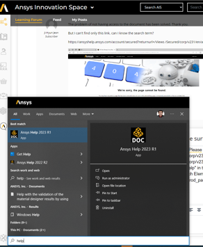

        • Ji-Hyun Jeon
          The problem of not having access to the document has been solved. Thank you.
          But I can't find only this link, can I know the search term?
        • Sampat Kumar
          Hi Ji,
          I have checked at my end and it’s working. I have attached the link again, Please try.
          https://ansyshelp.ansys.com/account/secured?returnurl=/Views/Secured/corp/v231/en/ans_elem/Hlp_E_SHELL131.html
          If you are not able to open the above-mentioned link then you can write “help” in the start window and then open the ansys help documents–> Command Reference–> SFE Command and Similarly search Elemement reference–> Element library–> shell131
          https://ansyshelp.ansys.com/account/secured?returnurl=/Views/Secured/prod_page.html?pn=Mechanical%20APDL&pid=MechanicalAPDL&prodver=22.2&lang=en
          Sampat
