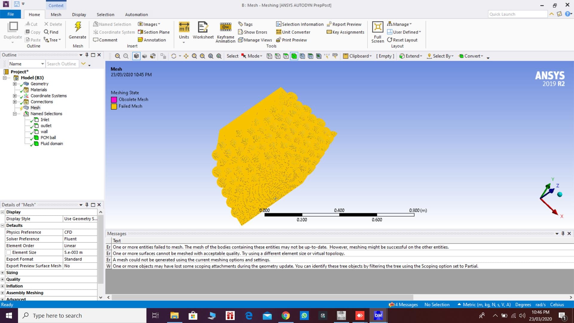

SubscriberTo simulate solidification and melting of PCM balls, I have separated the enclosure (fluid domaim) by Boolean-subtract. It results in 1 - part body.
There are two materials involved in my simulation, one is water and the other, PCM. Now, I can specify material for fluid domain. But, I don't know how to select material for PCM ball, which is represented as a empty space after boolean-subtract.
Looking for an early reply

Now I got 2 different bodies(PCM balls and Fluid domain). How should I mesh them separately.

SubscriberYou want all bodies in the same part. Select all bodies in the Outline, and right click to Form New Part.
You can assign mesh controls to each body separately. They will both be automatically meshed with shared nodes on the coincident faces so there will be no need for Contact.

SubscriberI think I need two bodies, so that I can specify fluid domain as a fluid and PCM balls as a solid in cell zone conditions.
So, Totally I need two bodies(PCM balls and Fluid domain), which is also to be meshed separately.Is there any connection to be created between them?

SubscriberYou have two bodies in two parts.
When the two bodies are in one part, the mesh automatically connects them using Shared Topology.
If you have two bodies and two parts, that is worse because now you need additional Contact elements to connect them.

So, after making it as a single part, it results in conformal mesh right ?
After doing that will I be able to assign different materials in Fluent. Which is water for a fluid domain and PCM properties for Balls.

SubscriberOnce you have 1 Part, 2 Bodies, you get a conformal mesh.
If you have two balls tangent, that creates a very sharp edge of fluid that is very difficult to mesh. It is easier to mesh if you either make a small gap between the balls or have a small overlap of the balls to get away from a 180 degree edge angle.

SubscriberOkay, I have made a gap of 0.2mm between the balls for the porous zone (Fluid domain), Is that fine ?
Now, mesh was successfully tranferred to fluent.
