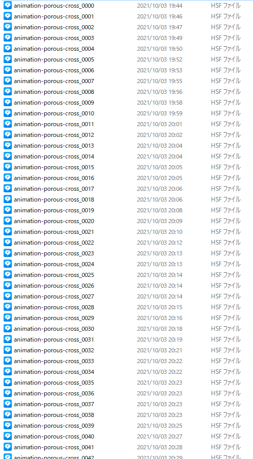

SubscriberI am a student using ANSYS Fluent at university.
I would like to ask you a question about saving simulation animations.
I am doing transient calculations and I am saving the frames for each time step as HSF files.
When I do this, the animation for each time step is saved as shown in the figure, but is it possible to output these files consecutively into one file?
For example, if I run a 10-second simulation that saves at a time step of 0.1 second, a total of 100 frames will be created.
I would like to output a file that combines all of them into one.
I would appreciate your advice.
October 18, 2021 at 9:59 amDrAmine
Ansys EmployeeNo you cannot do that. You need after having the files to playback the files and stores animation as video or pictures. After that you can remove all HSF frames.
