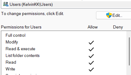

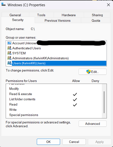

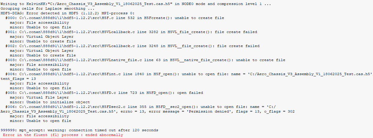

Saving to C:/ results in this:

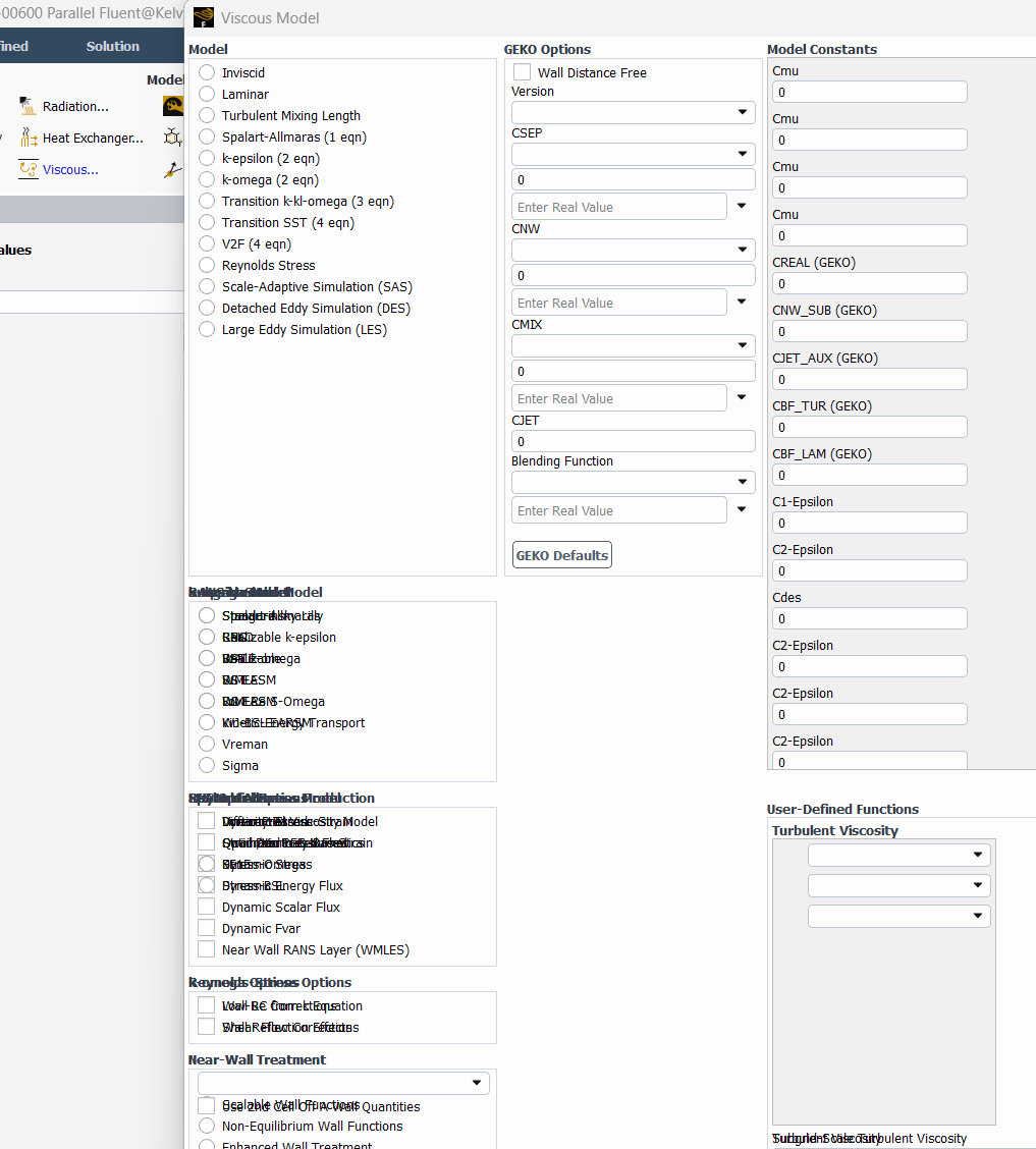

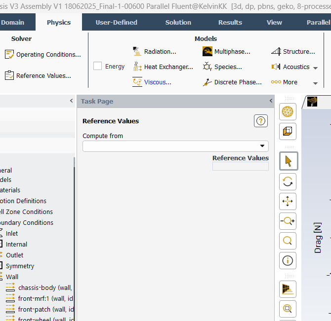

After that, Fluent won't let me perform tasks, all of the tasks either goes blank, or something weird happening to them:
Examples:
Values disappears.
Overlap in texts.
Same with after I try to import the initial simulation that I saved. I have to close Fluent and open it back up to be able to do tasks again.

Ansys EmployeeHello I am jumping into this conversation with some suggestions Kevin and Rob.
- When launching Fluent, please select mpi type as msmpi on the parallel tab of fluent launcher please
- just to double check, this is a "real" or "physical" Windows machine, right? this is not a VM or running MS Windows on a MacOS machine etc, right?
- Please do not save directly to C:\ (root of C drive) instead always create a folder with no spaces such as C:\my_fluent_project\project_abcd\ etc and save there
- please check drive properties for C: What is the file system type? hopefully it is NTFS. Is disk compression turned on ? it is off by default.
- Is the computer running any anti-virus which may interfere with writing files to disk or running the hdf5 compression that occurs during saving? by any chance can the system administrator temporarily disable the antivirus so you can test whether saving works when antivirus is turned off?
hope one of these steps helps

Forum ModeratorThat looks to be a cortex related failure - ie the head & display node has failed. Try without all of the spaces and double check write permissions.
What happens if you switch to Legacy for file IO in the Preferences?

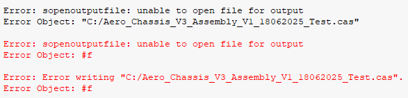

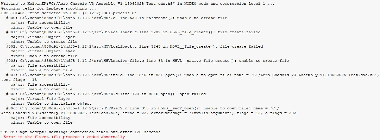

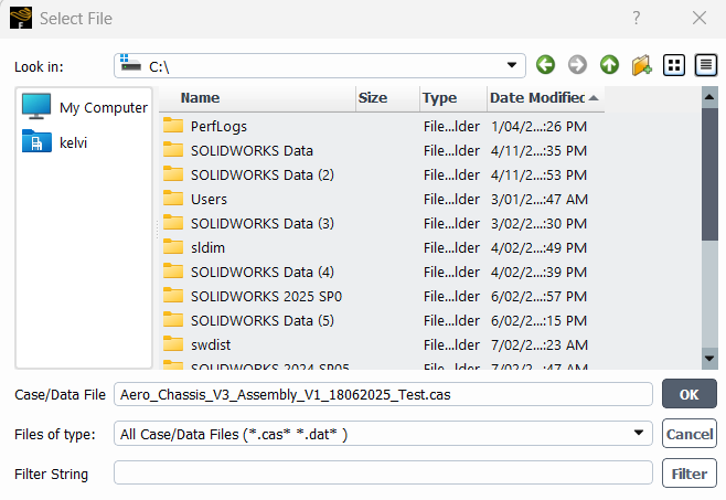

SubscriberAttempt 1:
When I tried to save with underscores (no spaces), it didn’t successfully save:
I saved Case & Data after initialization, before running the simulation. This is the file which I have been using to run simulations.
Strange, because I am able to open this file which is also in my Onedrive, but not the post-simulation one?!Q1) After my run simulation, do I just save data only, since I already have a case file from before, which I’m assuming won’t change, will it?

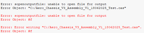

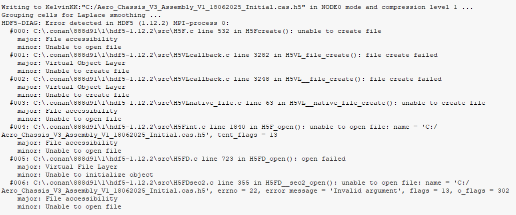

Attempt 2: Changing to Legacy setting before saving with underscores:
Tried to save in .cas .dat files…
But got this message:
Attempt 3 – Save by allowing myself to write:
Didn’t save successfully.
Attempt 4 – With CFF: I tried to save my pre-simulation case and data file that’s on my Onedrive to my C drive:
Strange.Attempt 5 – With Legacy. I tried to save my pre-simulation case and data file that’s on my Onedrive to my C drive:
Could all this also be because I didn't save my mesh file with underscores? But Fluent Solutions still read it, and saved my pre-simulation case and data file.

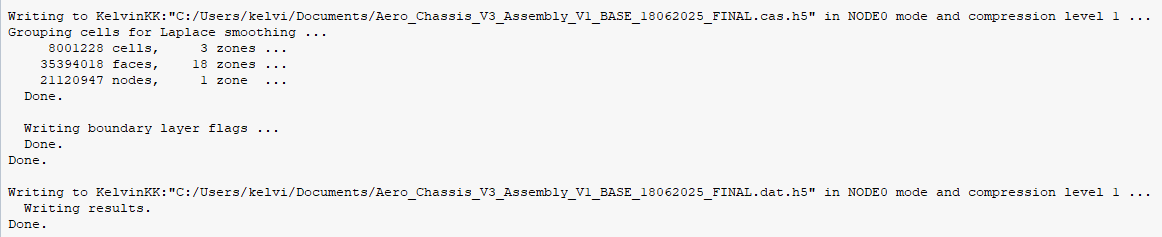

SubscriberUpdate:
Started Fluent as “ran as Admin”. Ran another test simulation to 500 iterations and completed (other sims I stopped the simulation myself. Not sure if it makes any difference to my issue, but I’ll just be detailed).
I was able to successfully save into my C drive and Onedrive:
Then, I was able to open both Test files (Case&Data) from my C drive and Onedrive.
