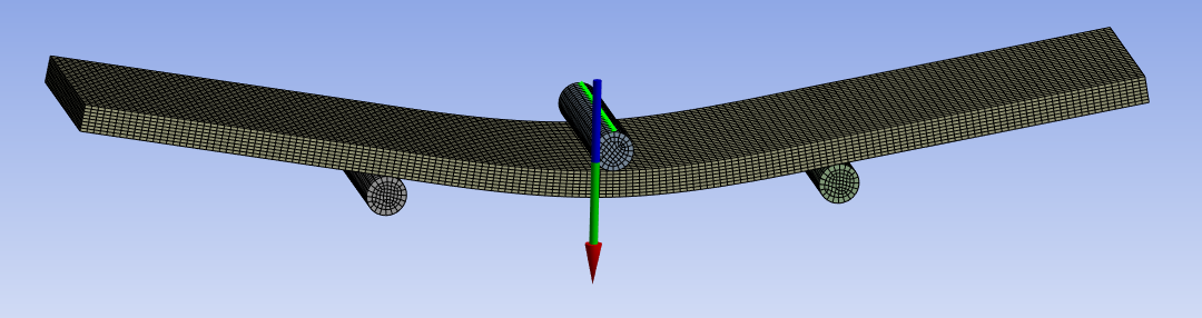

      Hello, Thank you for your time. As you can see in the image above, I am trying to simulate a 3-point bending test and I want to maximize the reaction force using direct optimization by giving material type as an input. As you can see there are 3 contacts, one load, and two supports. I change these contacts to frictional load and two frictionless supports before running the simulation as shown below in the picture.

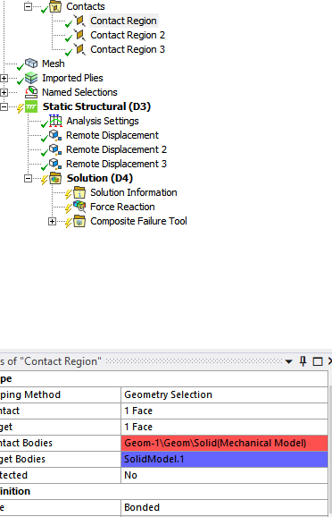

      After that, I run the optimization and when it finishes it gives me very high values of reaction force. Upon checking the tree in static structural I cam to know that the connections are changed to bonded contacts and not to the ones (One frictional load and two Frictionless supports) I kept at the time of the first simulation as shown below in the picture.
      c)
      So I wanted to ask if there are any settings that I can choose that will not change these contacts. Thank you.

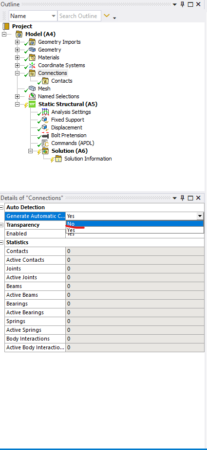

      I have another question on this:  Have you set the "Generate Automatic ... " setting under "Connections" to "No"?

      Yes, I already did that. When I change to automatic, it generates bonded contact as I mentioned above. This solid model is actually a composite designed in ACP Pre. It comprises two materials, each with 4 layers (A total of 8). I want to optimize the stacking sequence for maximum reaction force using direct optimization.

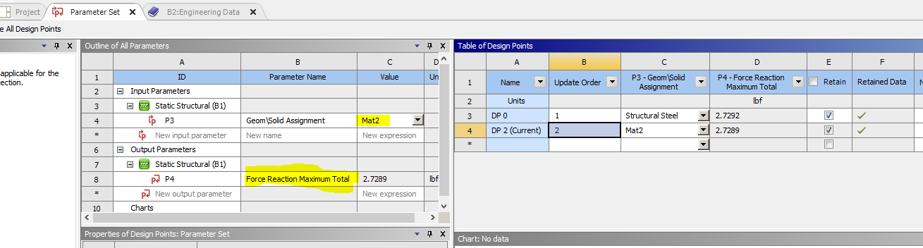

      You mentioned in an earlier post that you “…want to maximize the reaction force using direct optimization by giving material type as an input
      Since your material type assignment would be a fixed integer with a limited number of combinations, can you use WB-Parameter Manager to arrive at the Design Point that gives you max force (as an output parameter).
      This should preserve your contact settings.
    • 20217579
      Yes, I tried but again during the simulation for the new design point, the contacts are updated to Bonded contacts. Also, my solid model has 8 layers. And for each layer, there are 2 material options. So Identifying all the design points manually in Parameter Manager is also hectic.

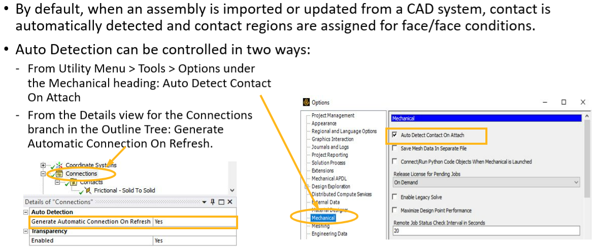

    • John Doyle
    • 20217579
      Yes, thank you for the info. I want the contacts to remain as I set them i.e. (Frictionless and Frictional) before running my simulation. I get bonded contacts with auto-generating contacts, which is not feasible for my analysis.
