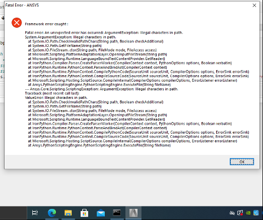

      However, I appear to be getting this error from ANSYS only when I try to run the journal from python (running it directly from WB works okay):
      Just in case, here's some of the journal script:
    • RK
      The error says there are illegal entries in the path, please make sure the characters in the path are the ones allowed to be used.
    • deadvermin97
      Okay, the problem has been resolved! While using subprocess.run() still results in the error, the subprocess.Popen() method works. Thanks.
