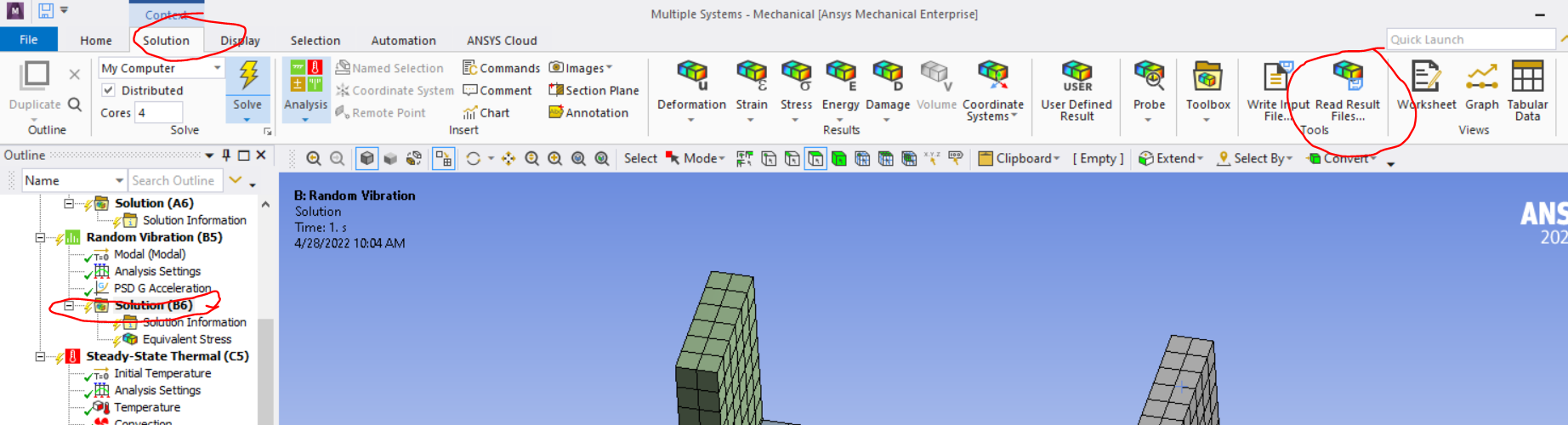

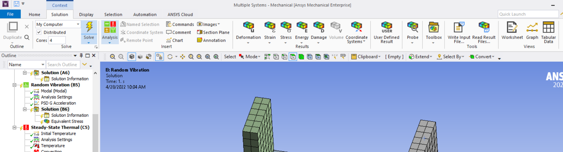

SubscriberHello, I have a stupid question for which I didn't find any answer (because I don't know how to phrase it): if I solved an analysis, then made a change (for example adding a force or changing the mesh) and then cancel this change I still need to solve again the model. How can I tell the program to retrieve the previous results?

Ansys EmployeeIf you did not do 'Clear all generated data' then possibly the results file is still available and you can try to reload it.
Go to 'Solution' --> right mouse click--> open solver files directory. Check if there is a results file (file.rst if structural, file.rth if thermal)
Click on Solution, Open the solution tab--> read results file as shown below. Read the file.rst.
April 28, 2022 at 3:15 pmEldor
SubscriberThank you it works!
