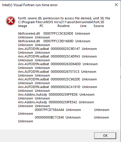

    • marc3llo
      I have the exact same error (C:\Program Files\ANSYS Inc\v212\aisol\bin\winx64\fort.38) Is there a solution?
    • Shyam Prasad V Atri
      check your firewall/network settings (it might be blocking ansys) or ansys installation folder permissions in your c drive to give full access permissions. it should solve the problem.
