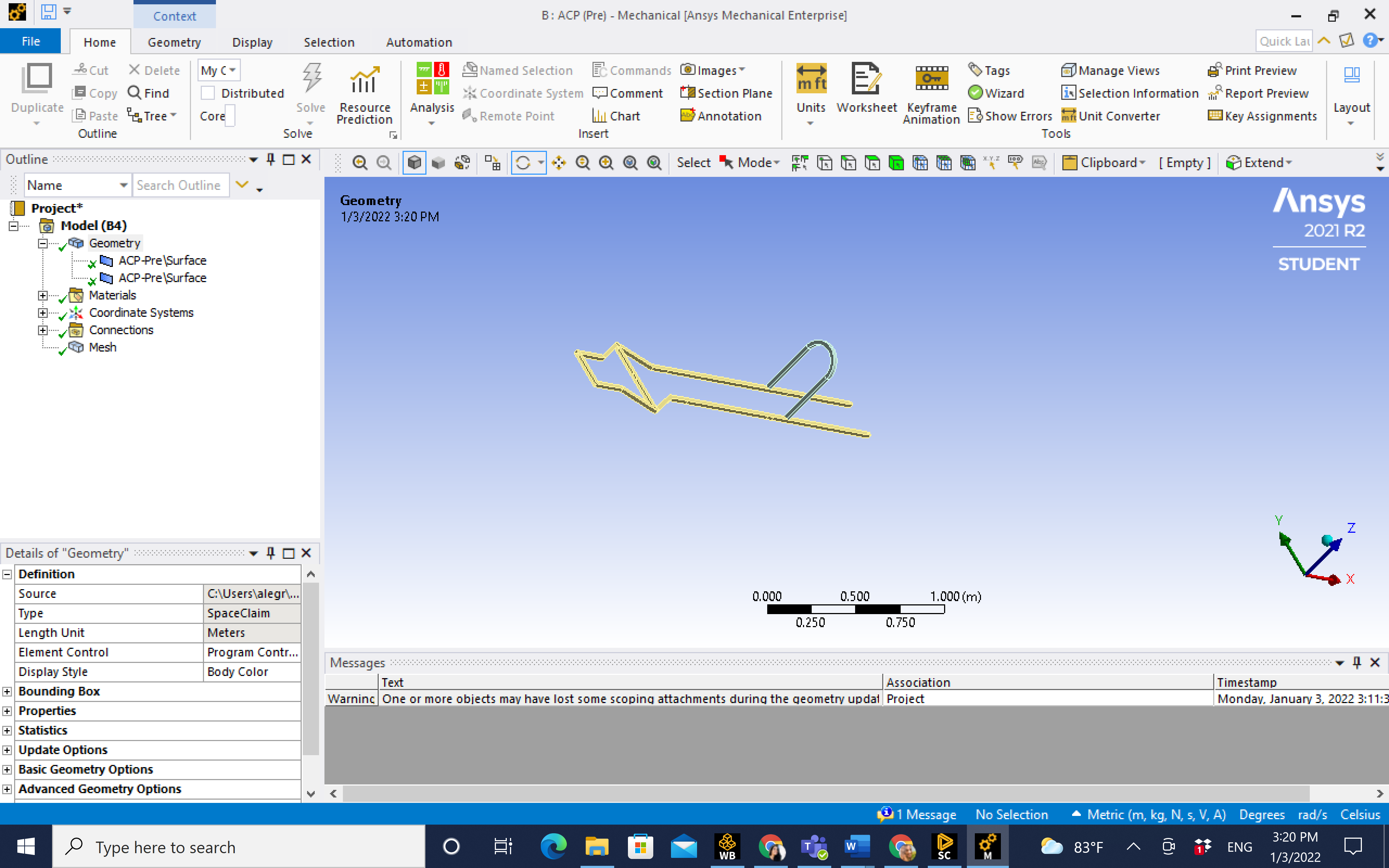

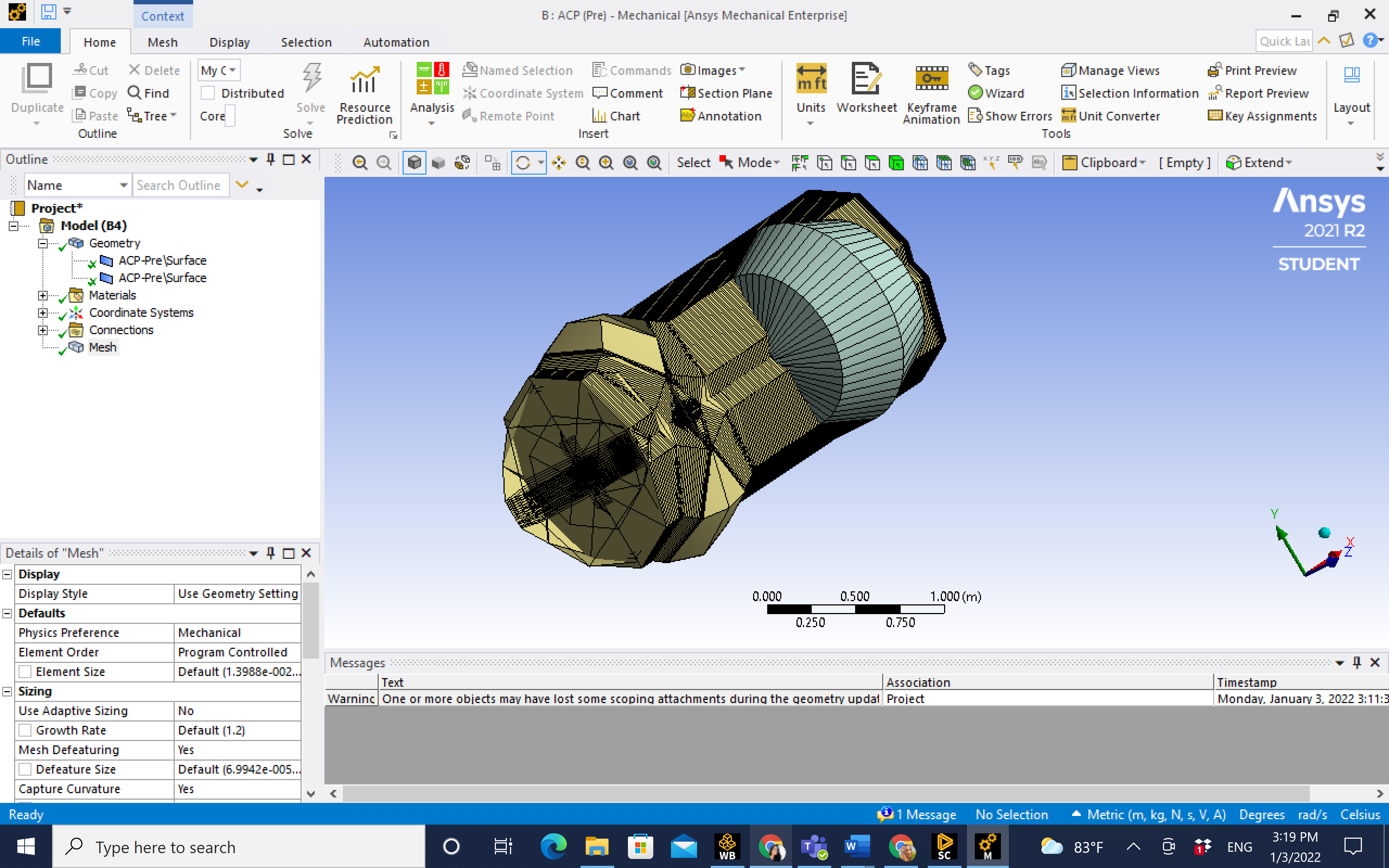

      Hi, can someone help me out, I dont know why everytime I click generate mesh it changes my whole structure.
      goes from this:
      to this:
