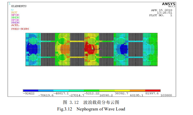

Ansys EmployeeHi, you can consider using the Hydrodynamics Pressure Add-on to load the pressure calculated in Aqwa to Static Structural and do a stress analysis in Static Structure. More details about the Hydrodynamics Pressure Add-on can be found in Aqwa User's Manual Section 8.1. Also, if you have access to Ansys Learning Hub, in Aqwa training materials, there are lecture and workshop slides on this subject.Â
Hope this helps.

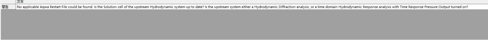

SubscriberHello, there is no pressure result in the time response option of my aqwa2021R1 version that cannot be imported into the static structure. How to solve this problem to generate the stress diagram of the structure in a static structure. There is an import result file option in the static structure, but the file suffix is required to be. rst or. rth. Can AQWA generate the corresponding file? Can I obtain a time-domain stress cloud map by uploading the result file
October 18, 2023 at 9:42 am
October 18, 2023 at 12:56 pm
Yu Bi
Ansys EmployeeHi, again, this is usually either due to HD Analysis has not been connected to Static Structure correctly, or the solution sell of HD has not been updated and Static Structural cell has not been refreshed.Â

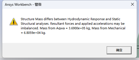

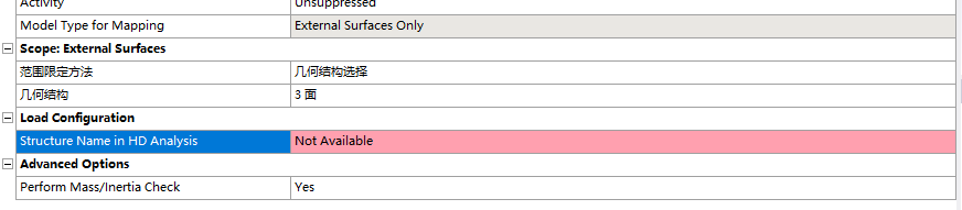

Yu Bi
Ansys EmployeeThe forces due to the additional damping will not be transferred to static structural, however, the structure acceleration which will be transferred to static structural to calculate the dynamic forces is calculated with the effect of the additional damping. This is the reason for the warning message.
Material properties and geometry decide the mass of the bodies in Static Structural.Â
Not quite understand what is happening in the picture, however, if there is no option in the UI to turn it off, then it means it cannot be turned off. Please check the User's Manual for more information.
