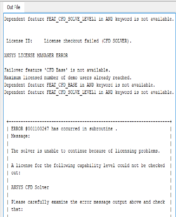

    • KevinPl
      I downloaded the Academic version of the software 2 weeks ago, and I'm getting messages saying the license will expire in 9 days already. How can I redo the license, as all the files I've created are in 2021 R1 version and aren't backward compatible.
      Thanks
    • Matt Madore
      Array This has been corrected, can you please redownload 2021R1 and reinstall?

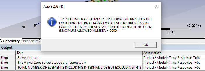

      When I first try to open AQWA from Ansys Workbench, I get the following warning:
      When I try to run the model, I get the following error:
      My model has multiple bodies interacting and hinges between them. There are cables for mooring.
      Thanks!
      I think you've exceeded the cell/node count for the Student solver. If you simplify the model it should work, otherwise you'll need a Research key.
    • Mike Pettit
      Hi baldaconi,
      Rob is right - the Student license is limited to 2000 diffracting panels, so you will need a Research license if you want to run large models. I guess that the Ansys Customisation Toolbox (ACT) is also excluded from Student use.
      Cheers, Mike

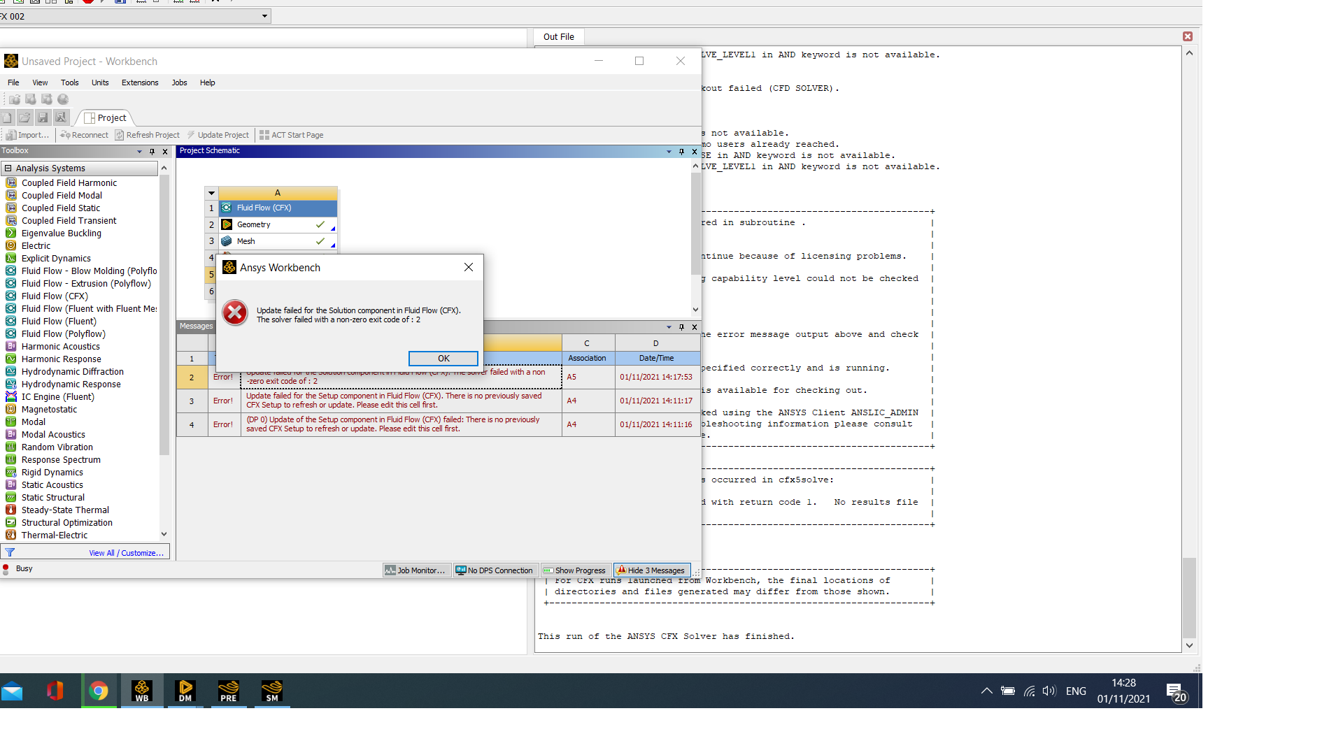

    • cwl6750084
      My ANSYS student 2020 R2 is expiring and when I tried downloading 2021 R2, there is no license file over there. How can I renew my student license? Thanks.
    • Vishal Ganore
      Please download a fresh copy of 2020R2 from the website which has an extended inbuilt license.

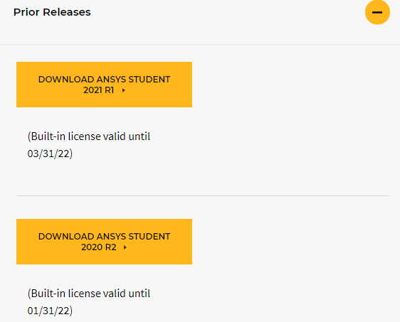

      So, when i found it, there is written "Built-in license valid until 7/31/21", that is the version that i have already. If i download it, the license will be renewed?
    • baldaconi
      That is weird. Maybe it is a problem of cache data of the page, because for me it displays other license expiring dates. Try refreshing or cleaning your browser history. Look what I got:
    • Dominick98
      I've tried refreshing or cleaning your browser history, but it not worked :(
    • George Karnos
      Browser history and browser cache can be 2 separate items. try deleting your browsers cache.
      Or, try using a different browser.
    • Dominick98
      Same thing on microsoft edge. I've already tried cleaning cache with CCleaner, but it not worked.
    • Huast
      Had the same problem. But, when I went to the US version instead of in my case the german version of the download page, the renewed version showed up.
    • Vishal Ganore
      Thanks for pointing it out. It seems to be an issue on our side. I have informed our web team to sort this out ASAP. Meanwhile, continue to use the US site for access.

      1) Go to this page: ansys.com/student
      2) Select student product type
      3) Go to prior release section
      4) 2020R2>Download [License key has been extended to 1/31/22]]
