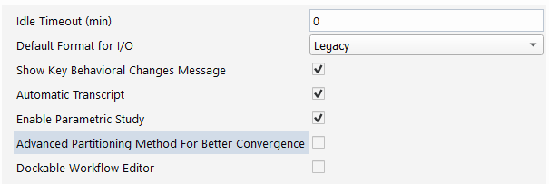

      I tried making legacy default in "Preference" but this did not change.

    • i.tamunodienye2
      Hello Keyur,
      I have done so but it's coming out as .cas.h5 and .dat.h5.

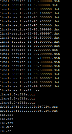

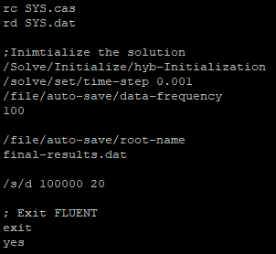

      Over the years the below journal TUI steps had been working for me with 2020R2 version. There's no h5 extension
      And get results like below

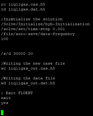

      With the 2022R2 version i did as shown below
      The simulation runs but no output files.

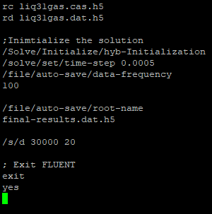

      I tried again to adjust like below
      Its the same thing. The simulations runs but no output files.

      I always use /file/rc or /file/rcd  and never rely on the TUI menu being in the root level. Other than you not needing to add .dat.h5 to the name it looks OK.
      However, depending on models, /s could be /server or /solve and then /d can be  /dpm-update, /dual-time-iterate or return an error.

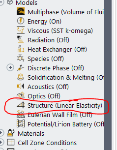

      Also, this is 1-way FSI simulation. Is there any line in the fluent journal specifically for fluid-structure interaction case?
    • i.tamunodienye2
      Note, I am doing 1-way FSI directly in Fluent.

      OK, use the h5 format and either reduce the autosave frequency or retain fewer files. I’d switch to running standalone so I could control things more easily.
      Edit, forgot to add, make sure you save case and data.
