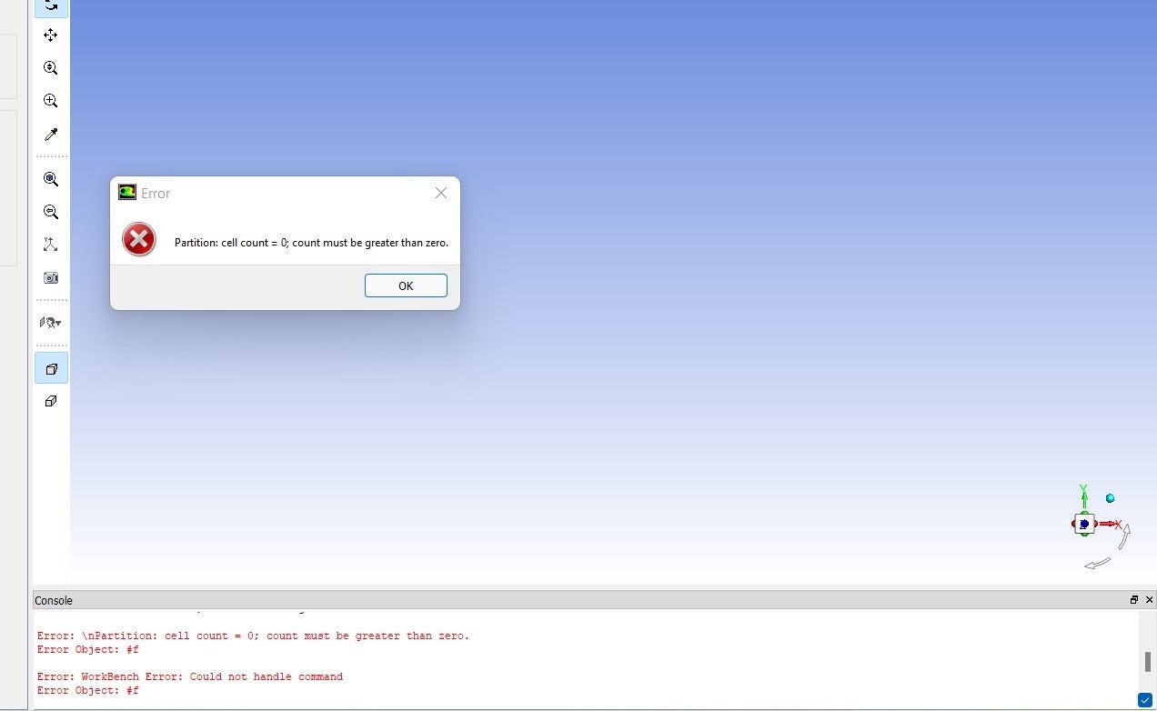

SubscriberFebruary 7, 2022 at 5:41 amKeyur Kanade
Ansys EmployeePlease make sure that you have volume mesh in ICEMCFD.
Error indicates that the mesh exported from ICEMCFD does not have volume mesh.
Regards Keyur
