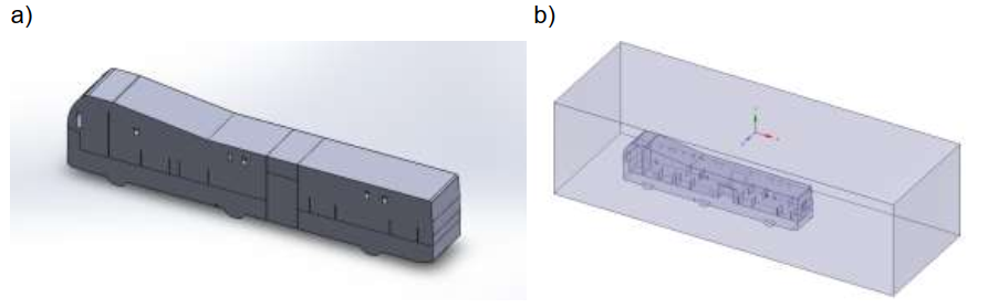

SubscriberHi in case file I have this a) Geometry and b) Domain :

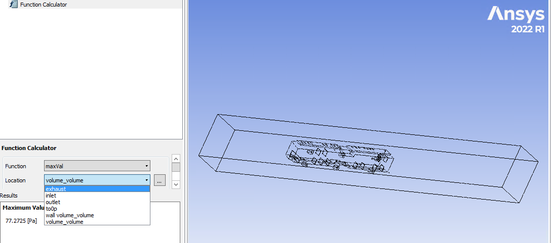

Forum ModeratorIf you want a point value use a point surface in Fluent. If you labelled the bus interior fluid region as being separate from the outside you can also create planes/iso-surfaces with the cell zone selected for a view that just considers the bus.

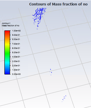

SubscriberThanks Rob for replying, if fora point value use a point surface I am going to get a puntual color for reading in the scale of color, not a exact number that is what I need.

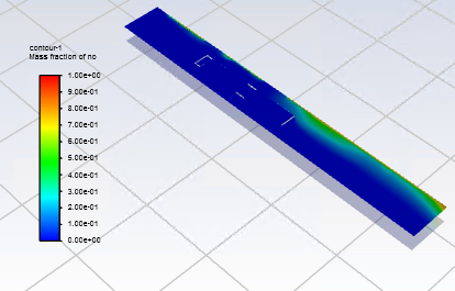

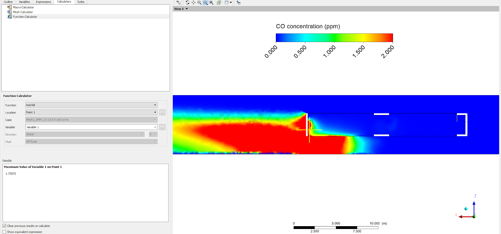

Forum ModeratorIn Fluent create a point. Then use the surface integrals to find the value at that point, vertex max is usually a good starting point. The second contour looks to not have the filled option ticked. You may also want to limit the range to local area (ie in the bus). Remember, the high NOx values will (hopefully) be outside, and a much lower concentration inside the passenger cabin.
May 4, 2022 at 6:59 pmMay 5, 2022 at 10:37 amRob
Forum ModeratorLooking at the plot, and assuming the bus is the bit with the "holes" in the surface I don't see why the NO concentration stays along the domain side. Are you sure it's correct as a NO concentration of 0.5 is likely going to be lethal! Change the scale to 0.0 to 0.1 and see how it looks.
