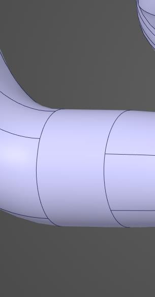

      In the volume shown above I need to be able to read the mass flow of the air passing throught the tube shown. I have only used montiors at inlets and outlets before but is there a way to set one up where shown?
      Thanks!

      You can create a plane at the mid volume location and monitor results on the plane. Please refer the 2022 R1 Quick Tip - Monitors on Construction Geometry - Ansys Knowledge for more information on how to do so.
      You can view Results on Lines and Planes in Ansys Discovery.
      Let me know if you need further assistance.
