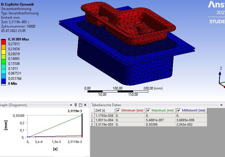

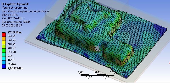

      I am currently using explicit dynamics in order to simulate a deep drawing process of an alumina cover. The simulation itself is successful, but i have a problem with it.
      The solver only shows the last and the first result of the total deformation and the mises tension (total steps: 10000). However, I am unable to get the deformation and tension at e.g step number 4500, etc. So I would like to how to achieve this goal?

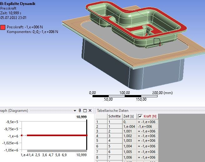

      As you can see I tried to apply a constant force over the whole simulation time. I thought this could be the problem...
      After that changed the data for the force to "from table". My first step was -1 Newton, Step Nr. 5000 was -1000 KN and the last step -1 Newton again (linear growth). Again, I can only obtain the last and first result...

      Since you want a linear ramp of Force, make this a 1-step analysis.  Say you use an End Time of 0.1, you can have just 2 rows in the Force Tabular Data.
      Under Analysis settings, make sure to use a large number such as 1000 on the Result Number of Points line to get 1000 frames of output.
    • david.mrozek
      Thanks to your ideas on how to solve my problem. In order to get result based on the step progression I combined your answers together in order to get the desired solution:
      The (1) result number of points must be combined with the option (2) step-aware output controls [YES]. The End time will than be adjusted to this parameters.
      This give me much better results than before and I can finally observe this process as a whole simulation.
