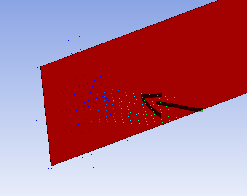

SubscriberHello, in using define_SPH_Injection_(option), how can I properly define contact between generated SPH particle and the FEA body?
There's no clear indication of the set being generated, I tied using part ID but no luck/crash.I appreciate the advice

Hello Dennis
Not sure exactly what you are after but if it is just the contact between SPH and solid Lagrange bodies then see this (sure you know this):
LSDYNA Bird — Welcome to LS-DYNA ExamplesThis is used also when using DEFINE_SPH_INJECTION -> in the contact use the PID defined in DEFINE_SPH_INJECTION (PID of new SPH) as SURFA and PART_SET or PART of solids in SURFB – see examples above.

*DEFINE_SPH_INJECTION
$#   pid    nsid    cid     vx     vy     vz    area    vmag
     1   Â*CONTACT_AUTOMATIC_NODES_TO_SURFACE_MPP_ID
$#   cid                                 title
     1                                   Â
$#  ignore    bckt   lcbckt   ns2trk  inititr   parmax   unused   cparm8
     0     1     0     0     0    0.0          0
$#  surfa   surfb  surfatyp  surfbtyp  saboxid  sbboxid    sapr    sbpr
     1     2     3     3     0     0     0     0---

I did a simple example and it works as we discussed.
example:
$#   cid                                 title
     1                                   Â
     0     1     0     0     0    0.0          0
     1     2     3     3     0     0     0     0
They interact with the plate as shown:
