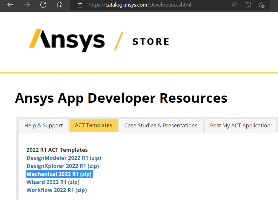

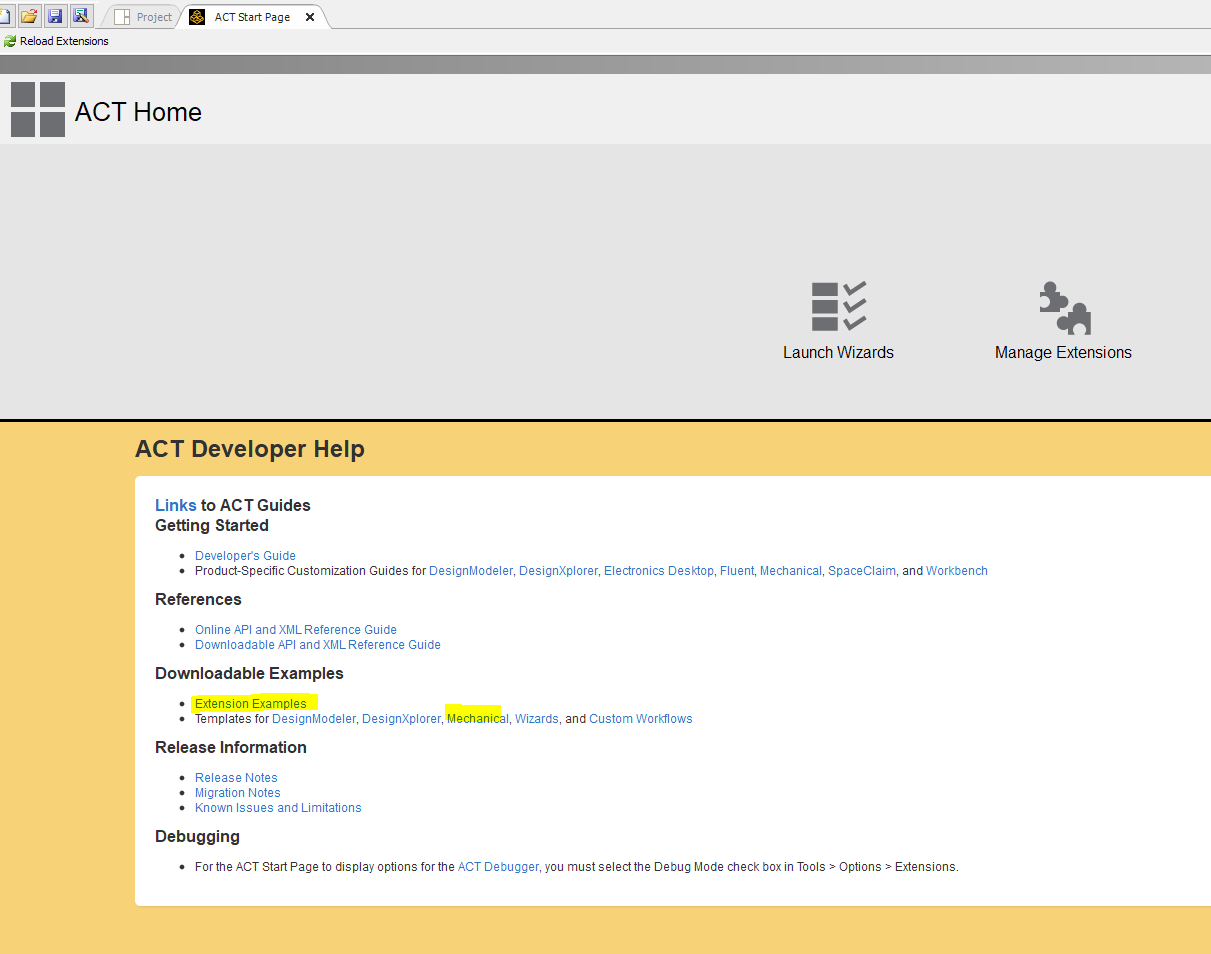

One way to do this is to make an act extension with say an object that has properties that are editable and need to be given by the user - for an example see th eDemoLoad example in the ACTExtensionEXamples provided and accessed via the Workbench UI (see below).

May 10, 2022 at 1:45 pmAniket Chavan
Forum ModeratorIn addition to what Erik has mentioned above, you can check the examples available at :
Ansys Store Developer Resources
You can create a custom load object in Mechanical where this value that you need from user as input is a parameter and simply run a parametric study.
