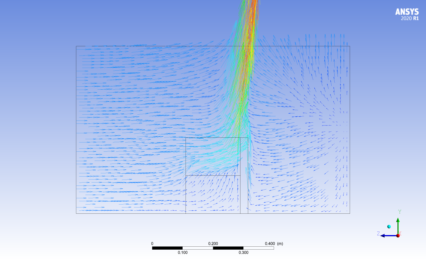

      Hi all,
      Symmetrical Geometry (figure 1a), explanations: A square cross-sectioned fume hood chamber ('A') having only a front opening, and a square cross-sectioned cookstove ('B') placed inside in it. Cookstove wall (solid) has some thickness which is also presented in the fluid domain. Cookstove ('B') has two different fluid heat generation sources inside it, divide as lower and upper parts of the cookstove. The lower part of the cookstove has the porous region heat generation and the upper part is the non-porous heat generation region.
      Models used in fluent: Steady-state, turbulent (k-epsilon, standard wall function), hot flow. Working fluid is air, density calculated using ideal gas law (gravity is on). Simulating a mixed convection flow: Airflow to the cookstove is driven by buoyancy (two different heat generation sources) and also by pressure drop at the outlet plane of fume hood.
      Boundary conditions: a. ('1', XY plane) Pressure inlet (Gauge Pr = 0 Pa), b. ('2', XZ plane) Pressure outlet (Gauge Pr is few Pa of negative Pr); c. ('3'), ('4'), and ('5') are the constant temperature wall boundaries. d. ('6') is symmetry face
      Interfaces: ('7') is the air entry face in the porous region,  ('8') is the air entry face in the non-porous region, and ('9') is the total air exit from the cookstove.
      Staff are not permitted to open or download attachments so please repost the images. Blocking reverse flow tends to give an artificial solution is isn't advised unless you know why you want to use it and why it's not going to alter your answer. Extending the domain is the solution. If you did that and didn't label or connect (share topology) the additional fluid zones you may find one or more is a solid, or that you have badly defined contact interface regions. If you can plot and post pathlines from the inlet it'll be clearer what's going on.

      @Rob I reposted the images, please see them and leave comments.

      What operating density did you set? Given the flow velocity I'd use incompressible ideal gas as you're nowhere near 0.3M
    • Thirumoorthy
      Yes, am calculating operating density using the incompressible ideal gas, which I already mentioned in post 1.
      Operating density is set in the Operating Conditions panel, it's a fixed point used in some calculations and is not the same as the gas density. If you've not set that it may explain some of the flow features.
      Initialise the model using the "outside" temperature and pressure (use the outside boundary and "standard initialisation". Then report the volume density. Use that value (to all 5-6 decimal places) in the operating conditions and re-run. Do not use "prevent reverse flow".
    • Thirumoorthy
      Yes, specifying operating density in operating conditions panel is working. It seems that using incompressible ideal gas for density calculation in natural convection, specifying operating density is necessary
      Read the background theory: it's obvious when you know but not as clear as it ought to be.
