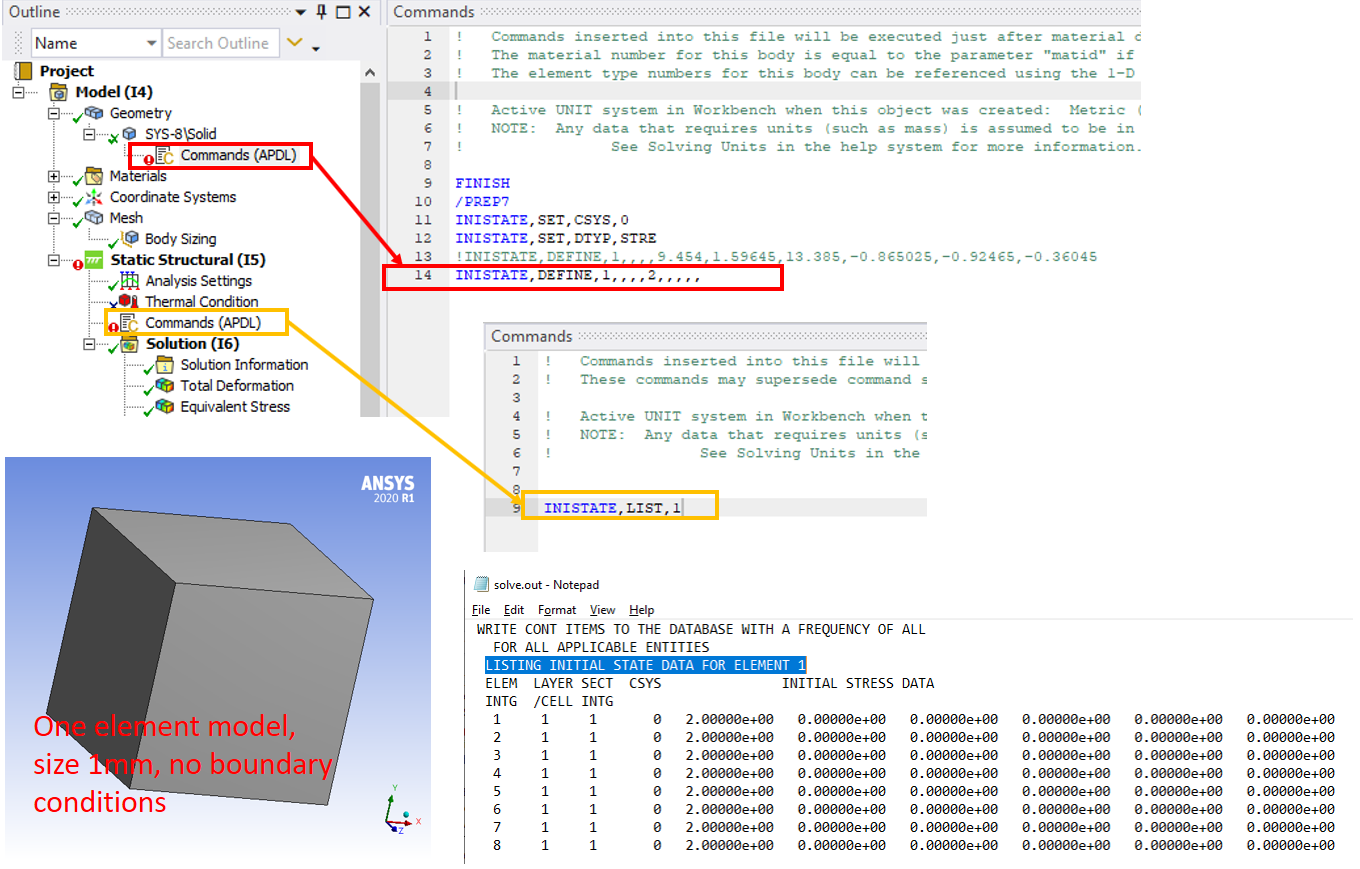

I use INISTATE command to import the initial stess for very element as shown below. Now I want to review the element stress in ANSYS and check whether the element stress has been imported correctly. How to plot the element stress after solution? By the way, my element is SOLID187, second oder. Thank you in advance!
May 18, 2021 at 9:42 amErKo
Ansys EmployeeHello
With: inistate,list
We can list/print all the inistate data in the solve.out file.
All the best
Erik
May 19, 2021 at 5:51 amHaiquan
SubscriberThank you very much for your feedback! I can see the initial data in solve.out file now.

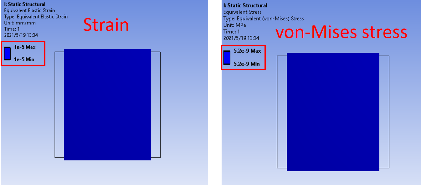

I checked this with a linear one element model, solid185, 8 nodes , and I applied initial stress 2Mpa in the X direction for the element as shown below. I didn't apply any load or boundary condition, I just inserted a command to list the initial stress. I solved the case and checked the result, the strain was 1e-5, it made sense, as the material was steel with Young's modulus 200000Mpa(2/200000=1e-5). But if I checked the von-Mises stress, it was 5.2e-9Mpa, it was not the initial stress 2Mpa. I feel very confused about this stress.
By the way, it seems the initial stress is applied to the integration points in the element, am I correct?

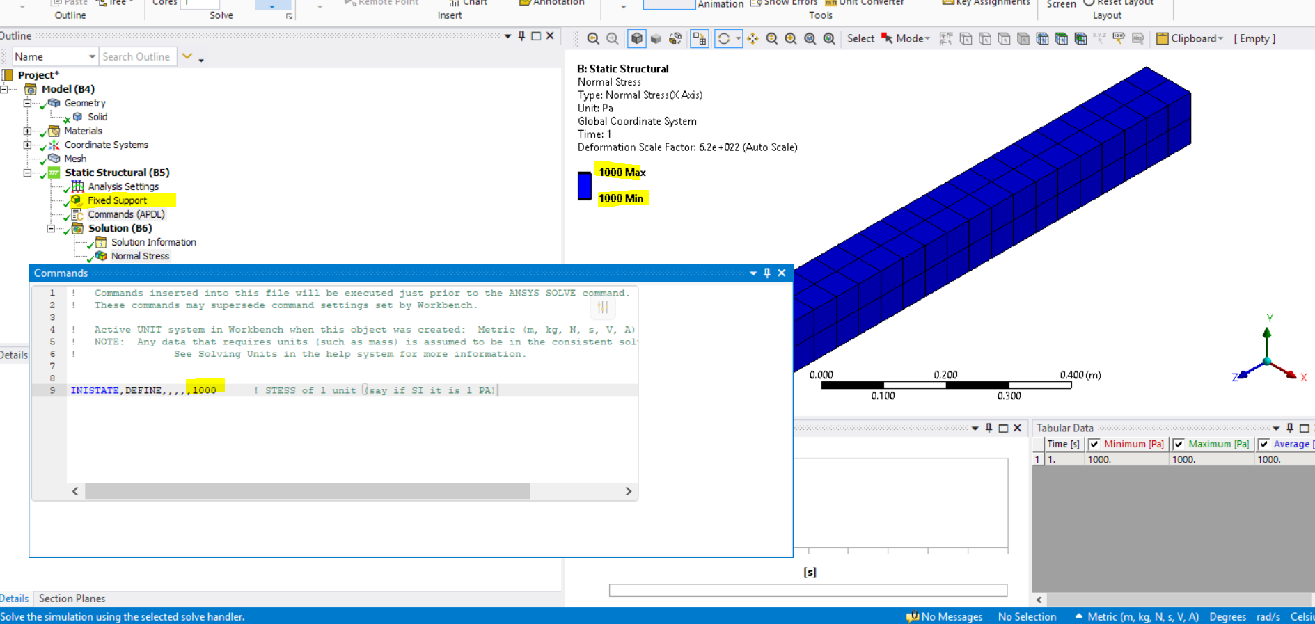

Well if we apply an initial preload and do not have any boundary conditions then it will deform and we will not have any pre stress as you see - if you fix all faces than you should see the normal stress in x be equal to your initial stress preload. So below all faces are fixed and an SX=1000 has been applied and that is what we get out - so to see all the preload we need to prevent movement otherwise we loose it.
Yes it seems so since we do calculate stresses at Gauss points.
