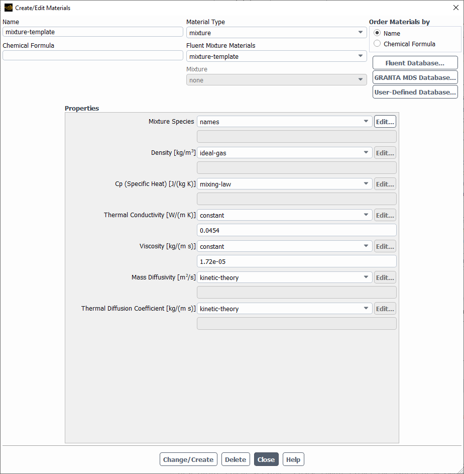

SubscriberI selected kinetic theory in mass diffusivity and thermal diffusion coefficient of mixture template panel but only thermal diffusion coefficient is coming in the plotting panel of XY plot (under species). I used custom defined functions for other variables to calculate, but in that case I dont think its gonna work, correct me if I am wrong.

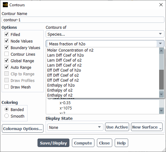

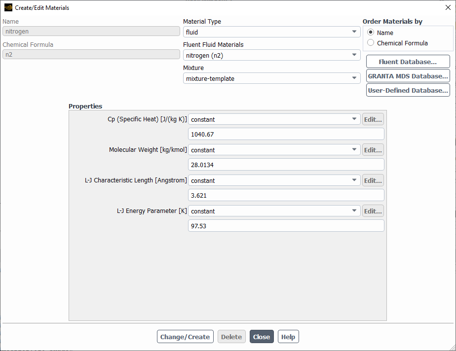

Forum ModeratorLook up the thread. My example had 3 species in the mixture. What are you seeing?

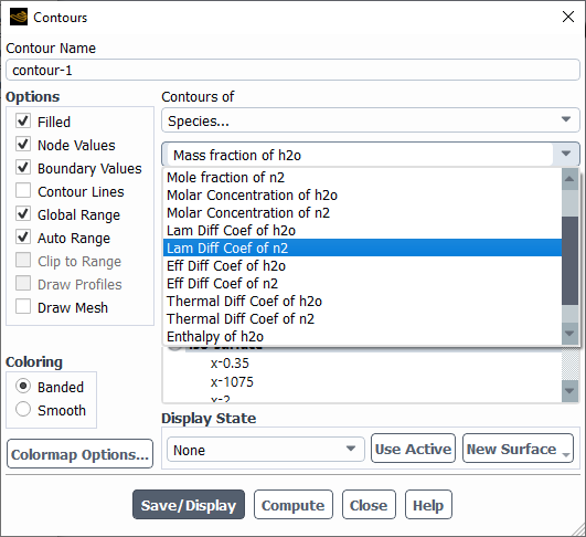

I am able to see two screenshots. One is for nitrogen material and second is mixture template, but I asked for the contours panel, because when we choose kinetic theory in mixture template for mass and thermal diffusion coefficient it sets automatically and I would like to plot the binary diffusion coefficient for those values which has been set up by fluent automatically. Please see the attached screenshot.
Here only thermal diffusion coefficient is coming but mass diffucion coefficients are not there, when I choose kinetic theory in mixture template.

In your case diffusivities are coming in the contours panel despite choosing kinetic theory, then what would be the issue in my case. (My case is laminar and I have choosen kinetic theory for viscocity, thermal, conductivity of individual species and kinetic theory in mixture template for diffusion coeffcient and thermal diffusion coefficient).
Is it because I am using ansys 2020R2 and you are using newer version?
If its version issue please let me know.

Forum ModeratorI'm using 2022R2, and looks like I can pick kinetic theory for components and then again for the diffusivity options.
