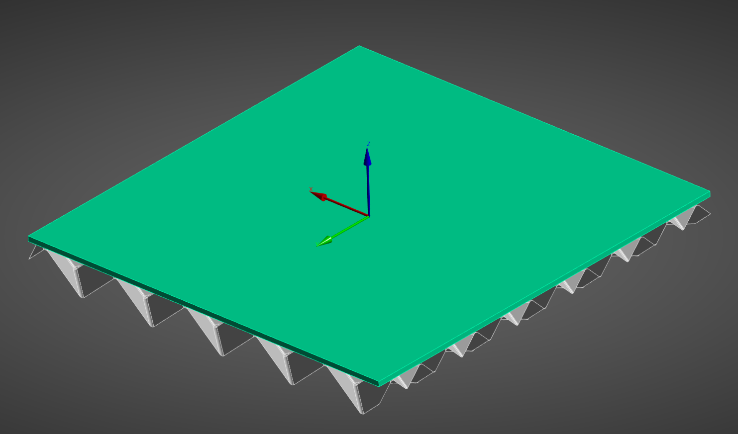

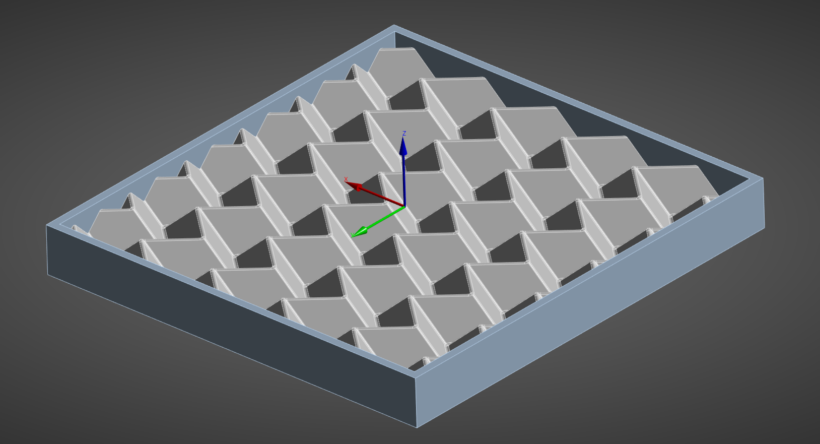

      Hi everyone,
      I am currently simulating the crushing behaviour of a Miura plate using LS-DYNA Workbench and have encountered an issue while trying to extract the force–displacement response.
      In my setup, the plate is supported on a rigid box, while a rigid top platen (crosshead) is prescribed a displacement in the transverse direction. The bottom box is fully constrained using a rigid body definition, and the top platen is only allowed to move in the loading direction.
      My goal is to obtain the force exerted by the top platen on the Miura plate so that I can plot a force versus displacement curve. However, when I attempt to extract this using the “reaction force” or “external force” options in Workbench, I receive an error message stating: “Extraction of result failed.”
      I would appreciate any guidance on how to correctly obtain the force output for this type of displacement-controlled simulation.
