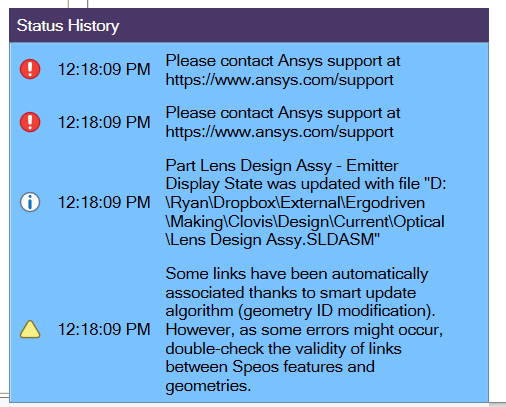

      After doing the Speos Geometry Update (which may still be using 2021 based on the licensing pop-up), I see the following from Speos status history. The two red ! are unexpected.
