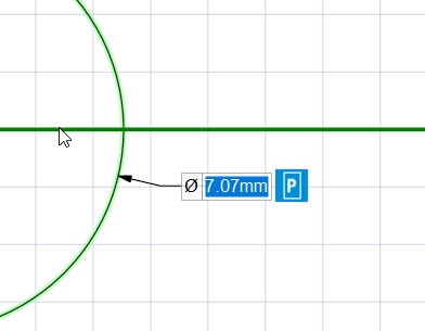

      For parameterizing the feature, move the respective geometry to a new component and a P checkbox will appear next to the dimensions whenever the part is active. By checking the P checkbox the respective feature is parameterized.
      If you are unable to view the P checkbox besides the dimensions, On the bottom left of the window, click on the 'Groups ' tab and click on 'Create Parameter' option.
