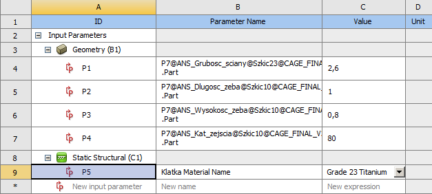

I am trying to set material assignment for one of the objects as parameter for the DOE.
I set it in Parameter Set and it's all good:
But it doesn't appear nowhere in the DOE, also when I import Design Points from Parameter Set it imports only half of them (one half is Titanium, other is PEEK).
How can I set it properly so all of the Design Points will be visible in the DOE?
