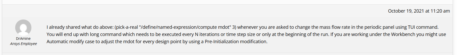

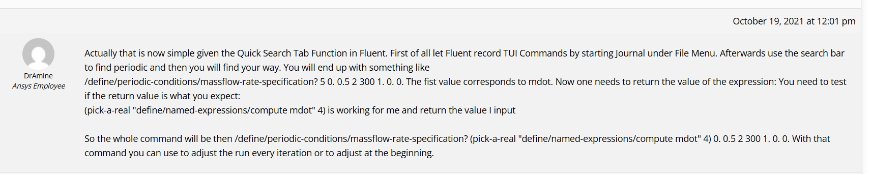

SubscriberI’ve been searching for a solution to this and found an interesting suggestion from an Ansys Employee (DrAmine) in another thread (see attached screenshot).DrAmine states that for those working under Workbench, it is possible to use 'Automatic modify case' to adjust the mass flow rate for every design point by using a 'Pre-Initialization modification.' I have already created a named expression called mdot and enabled it as an Input Parameter, but I am struggling to find the exact location or the correct setup for this 'Pre-Initialization' step in the Workbench/Fluent workflow. I tried the TUI command mentioned in the post, but I couldn't get it to link correctly to the Workbench Parameter Set.Could anyone provide a step-by-step guide or more details on how to access this 'Automatic modify case' feature? It seems like this is exactly what is needed to automate periodic mass flow rates across multiple design points.Thank you for your help! -
April 29, 2026 at 2:02 pm
Rob
Forum ModeratorThat will be in Calculation Activities.

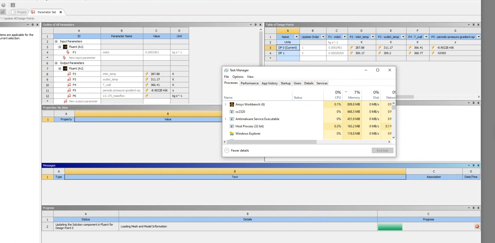

SubscriberI tried that, but it seems to be causing a bug. When I start the analysis for the parameters from Workbench, it gets stuck at the 'loading mesh and information' stage and just hangs there. It doesn't move past that point. Any idea why it might be bugging out at that specific stage
April 29, 2026 at 2:28 pm
Rob
Forum ModeratorIt's possible it's not liking the expression and parameter. How many of these models do you need? You might be about as quick just running the models with a normal TUI command or manually changing the mass flow value.

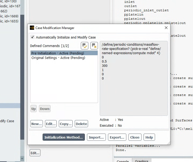

SubscriberHi everyone,You are right about PyFluent being a great tool, but unfortunately, I don’t have the time to dive into learning it at the moment, so I’m trying to solve this within the standard workflow.I am using the “Automatic Modify Case” feature with Pre-Initialization to adjust my periodic conditions. Specifically, I use a custom script within the pre-initialization step to update my mass flow rate from an initial value of 0 to my target value.The good news is that the logic works—the analysis runs correctly and the mass flow updates as expected. However, the problem arises after the analysis is finished. When I try to check or update the parameters back in the Workbench Project Schematic, it gets stuck on the “Loading mesh and information” stage and doesn’t progress.I’ve attached photos of my setup and the specific code I’m using in the Pre-Initialization step (which might not be visible in the general settings).Has anyone encountered this “hanging” issue when using pre-initialization scripts to modify parameters? Any advice on how to get Workbench to recognize the completed state without getting stuck would be greatly appreciated! -
